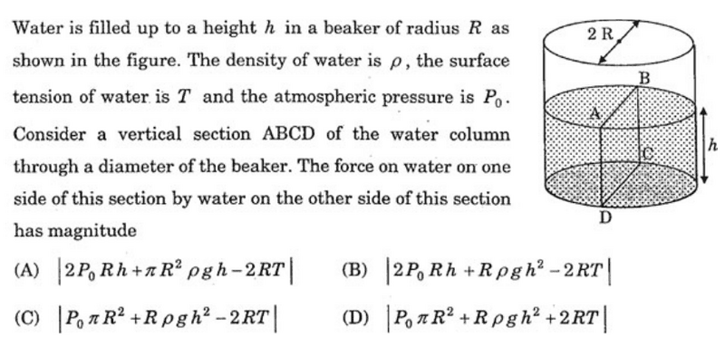

As shown in the figure below, there is a beaker of radius R . Water is filled in the beaker up to a height h . The density of water is ρ , the surface tension of water is T and the atmospheric pressure is P_0 . Consider a vertical section ABCD of the water column through a diameter of the beaker. What is the magnitude of the force on the water on one side of this section by the water on the other side of this section ?:
P= pgh
My attempt:
Using the equation to find excess pressure across two surfaces, we get
##P_{inside}= P_0 + S( 1/r_1 + 1/r_2 )## where r1 and r2 are the curvatures of the cylinder and the surface perpendicular to it( so infinite curvature)
hence, ##P_{inside}= P_0 + S/R= P_{AB}##
however, this varies with depth, and it is better to say that the expression for P_inside represents the pressure at the surface AB (see figure)
Hence, the pressure at CD should be,
##P_{CD} = P_0 + \rho gH + S/R ##
now as is force is acting on the projected area of ##A= 2RH##, we take the average pressure on the area to find the net force:
##P_{avg} = (P_{CD} + P_{AB} )/2 = P_0 + S/R +\rho g H ##
And multiplying by the area to get the net force, I get
## F_{net} = 2P_ 0 RH + 2SR + \rho g RH^2 ##
note: I have assumed surface tension of water as S.
however, my answer closely matches option B (which is the right answer),but differs by 4SH.
Why is there this difference? I have not included surface tension as a force as it is already taken into account by the excess pressure.

The surface tension has no effect on the pressure distribution within the beaker. The force from hydrostatic pressure is independent of the surface tension force.
The force ascribable to the hydrostatic pressure distribution is $$(2Rh)\left(P_0+\frac{\rho gh}{2}\right)$$The force ascribable to the surface tension occurs on the upper surface, and is equal to $$(2R)S$$ (in the opposite direction of the pressure force). So the total force exerted by the fluid on the left half of the beaker on the fluid in the fluid in the right half of the beaker is $$(2Rh)\left(P_0+\frac{\rho gh}{2}\right)-(2R)S$$
Is there a mistake/omission in the original question?
There seems to be an unstated assumption that the liquid-beaker contact-angle is 90##^{\circ}##, i.e. there is no curved meniscus where the liquid’s surface meets the beaker. Without this assumption there would be additional tension forces on sides BC, CD and DA.
yes, this was what I meant. I wanted to say that when we take the force on one of the cylindrical segments, then we include surface tension apart from pressure.

I don't think so, this is a JEE advanced question picked right from the official paper so must be right, I think what you are saying is already depicted in the diagram..
palaphys said:
If you rely on the diagram - which shows no curved meniscus - then yes. But note that 'official' examination questions do occasionally have flaws - it happens! Just my opinion though.
For information, it may be worth adding that ##S( 1/r_1 + 1/r_2 )## (from Post #1) is inappropriate here. It is called the Laplace pressure and is the pressure-difference across the boundary-surface between two different fluids.
It is not helpful in this problem as ABCD is not a boundary-surface: it has the same fluid on both sides and, anyway it is flat – so ##r_1=r_2=\infty##.

The question asks for the net force each half exerts on the other.
Surface tension results from cohesive forces between the molecules of the liquid. So it acts throughout the volume, but is usually only evident at a surface.
But of course, when the molecules get too close together these are balanced by repulsive forces, so other than the pressure, as calculated the usual way, there is no net force between the two halves.
This applies at the surface too. Yes, there is extra horizontal attraction because of the absence of water molecules above, but having pulled the molecules in the surface a bit closer together it is balanced by an increase in the repulsive forces.
In short, there should not be a surface tension component in the answer.

Is there something wrong with the following argument?
1. We start with a beaker of liquid (Fig.1). ‘L’ is the liquid to the left of AD and ‘R’ is the liquid to the right of AD:
2. Using magic, we instantaneously remove R (Fig.2):
3. The surface tension will cause the corner of L becomes curved (Fig. 3):
(Admittedly this situation will only last for a short time until bulk flow of the liquid becomes significant but we could be using a viscous liquid in an environment with a low gravity/low atmospheric pressure.)
4. The removal of R allowed the liquid at the corner of L to move left, to form the curve. This implies that before removal, R was exerting a force (acting right) on the liquid surface at the corner of L. The magnitude of this force is the surface tension term (2RT).

The curvature of the free surface is negligible, except in close proximity to the cylindrical boundary of the beaker. This pressure deviation dies out very rapidly with distance from the beaker wall, and is important only in establishing the small meniscus.
As for the effect of surface tension in the free surface contributing to the answer, in the first figure of response #18, the fluid on the right exerts a tensile surface tension force on the fluid on the left (within the overall free surface). This tensile force is (2R)S.
