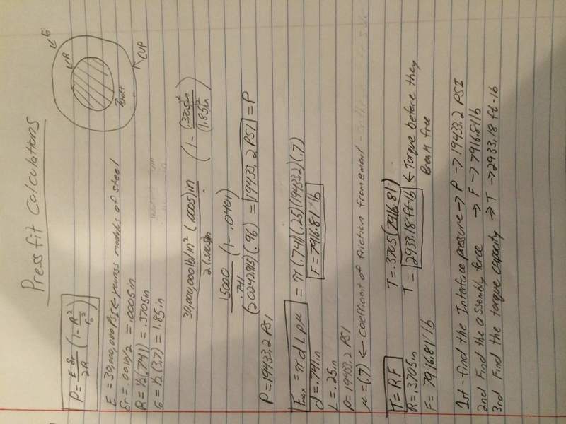

Hello all new to the forums but I have a question. I need to find out the force that holds two pressed objects together. For example I have a piece with a diameter of 1.000 in and another piece (the shaft) with has a diameter of 1.001. The shaft is inserted .25in into the 1.000in opening. The open diameter is heated up while the shaft is frozen and then the shaft is inserted into the opening. I need to pretty much figure out how to find how much force the shaft can take before it starts to spin in the other pieces open diameter.
Im assuming there is friction force and the force of the two objects pressed together I just can't seem to figure out how to go about finding these forces.

Yes I do have knowledge about this I'm actually in a strength of materials course right now but for some reason I just can not wrap my head around this problem. It's not for school this isn't a homework problem or anything it's for an internship I have right now.
The material is 52100 steel.
E=30,000,000psi
Poisson's ration = .30
I'm thinking maybe I could find the strain but I'm not sure about the deformation of the objects would it be .0001in, which the difference in the two diameters, Over the smaller open diameter 1in?

Can someone review this work and tell me if I'm correct please.
