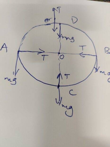

A mass connected to one end of a rigid rod rotates at constant speed in a vertical plane about the
other end of the rod (please see below). The force exerted by the rod on the mass is
A. zero everywhere.
B. constant in magnitude.
C. always directed towards the centre.
D. a minimum at the top of the circular path.
centripetal force
(A) and (B) are obviously wrong but I think both (C) and (D) are correct.
At the top, the forces acting on the mass are tension and weight, both directed downwards so the equation of motion will be:
$$\text{Tension}+\text{Weight}=m.a$$
$$\text{Tension}=m.a-\text{Weight}$$
Based on that equation, tension will be minimum at the top position
But the direction of tension is always towards the center as the mass moves in circle.
Am I missing something?

To help decide if (C) is correct, draw a free body diagram for the ball when the rod is horizontal.

Doesn't a rod always push the connected object as compared to a string which will always pull a connected object? Or is it that tension in a rod can be either push or pull depending on the scenario?
At horizontal position, tension will always be towards center to supply the centripetal force. At bottom most position also, it's directed towards the center since net force of centripetal force must point towards the center. But at the topmost position, tension could point towards or away from center since mg force is already pointing towards the center.

Consider the instant when the rod is vertical and the ball is at the top of the circle. Compare the case where the rod is rotating extremely slowly to the case where the rod is rotating extremely rapidly.
Would it be possible for the rod to rotate at a speed such that the rod is neither pushing or pulling on the ball when the ball is at the top?
What can you say about the direction of the net force that the rod exerts on the ball when the rod is horizontal?

Yes, if the value of mg equals the value of centripetal force, so no tension force is needed i.e mg force supplies the full centripetal force.

The net force would be the vector sum of vertically downward mg force and the horizontal radially inward tension force. So the direction of net force is going to be pointing downward and inward but at some acute angle to the vertical.
The free body diagram is easy for positions A,B and C, but at position D there are two possibilities since tension could point up or down as shown in diagram.

Are you sure that the rod's force on the ball would have a downward component rather than an upward component?

Let say the mass is at position of 3 o'clock. The force acting on the mass will be tension to the left (center of circle) and weight downwards. Is this correct?

It is not quite correct. The rod does not exert only a tension force to the left.
The mass is moving at constant speed in a circle. So, when the mass is at 3 o'clock, what must be the direction of the net force on the mass?
Use a free-body diagram of the mass when it is at 3 o'clock to deduce the directions of the vertical and horizontal components of the force that the rod exerts on the mass. (The question is concerned with the force exerted by the rod on the mass.)

And generally, you can think of the rod as having to provide two forces, one associated with gravity and one associated with the rotation.
Consider how the magnitudes and directions of these change over time, and what that tells you about the magnitude and direction of the sum.

Ah I see. Actually I have another question that I want to ask after I understand about this question. My next question will be related to weight of the mass, what effect it would have on the motion. It turns out that both hints also cover that question.
There should be upward force acting on the mass to balance weight so the net vertical force on the mass is zero to assure the mass moves with constant speed. This is provided by the rod so the force on the mass by the rod will be to the left and upwards and the resultant force by the rod will be slanted to the top left (option (C) is wrong)
Would it be the same if the rod is changed to string? I always think that if the object moving in vertical circle, the tension will always only be directed to center of circle. If the object moves with constant speed, it means that the string must also provide upwards force to counter the weight, yes?
The possibility for string to only provides force directed to center if the object moves with varying speed. Is this correct?
... and since string cannot provide a force other than along itself, the speed cannot be constant.

The string can provide vertical force while it is itself vertical, but it cannot provide a tangential force.
Can you push a ball along the ground with a vertical stick?
Can you push a ball along the ground with a vertical string?

In topmost position, the rod would exert an upwards push force on the ball; it couldn't pull the ball downwards at this position. Does that sound right?

It depends how fast the rotation is. Which is larger, g or ##r\omega^2##?

If centripetal acceleration > g then T will be downwards. ##(mg + T = mr\omega^2)##
If centripetal acceleration < g then T will be upwards. ##(mg - T = mr\omega^2)##
If centripetal acceleration = g then T will be zero and ball is in free fall. ##(mg = mr\omega^2)##

Either you analyze the forces from the point of reference of the mass or the bar, you need to treat the problem as a vectors addition.
One vector is vertical and constant.
The other vector has inward radial direction and its magnitude depends on the angular velocity.
Your post #5 shows the free body diagram of the forces acting on the mass.
The magnitude of T could be very small for the case of a Ferris whell, the main force acting on the hanging basket would be the persistently mg.
The magnitude of T could be very high for the case of an airplane propeller.
Still, for both cases, the resultant net force at any position of the circular trajectory, except top and bottom points, could never be purely vertical or radial.

If, again, we tilt the plane of rotation until making it perfectly horizontal, the rod simultaneously will force the mass to rotate and to not fall or to keep the same height: two forces, one rotating horizontally and another moving vertically, that become one net force (not purely vertical or horizontal).
vcsharp2003 said:
I am trying to reason why in the horizontal position the net force needs to be radially inward.
Not sure what you mean by "need" there.
We know it is radially inward because we are told the mass moves in a circle at uniform speed. Presumably this is arranged by a varying torque applied at the axle on which the rod rotates.
We do not have to worry about what provides that torque, but an easy way would be that the rod extends the same distance the other side of the axle and carries an identical counterbalancing mass.
vcsharp2003 said:
But speed of ball in vertical motion is constant, so tangential acceleration needs to be zero at every point of its path. The rod, unlike a string, can exert an upward force on ball.
Is this an action-reaction force? Which means there will be a force downward (with the same in magnitude as the force you have stated) that applies on the rod?

  • #32
Is it not possible for the end of the rod to be the one which keep the speed constant? As what @vcsharp2003 is trying to say.

  • #34
I was just trying to decide whether ##a_t>0## or ##a_t=0##, where ##a_t## stands for tangential acceleration in horizontal position. I wasn't trying to understand why speed is constant, which you've explained through a varying torque mechanism.
  • #35
Tangential acceleration is the component of acceleration parallel to the velocity. If speed is constant, that must be zero.
(In vectors, ##0=\frac{d}{dt}v^2=\frac{d}{dt}\vec v^2=2\vec v.\dot{\vec v}=2||\vec v|| a_t##.)
