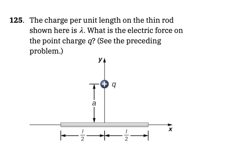

The charge per unit length on the thin rod shown here is What is the electric force on the point charge q? (See the preceding problem.)
