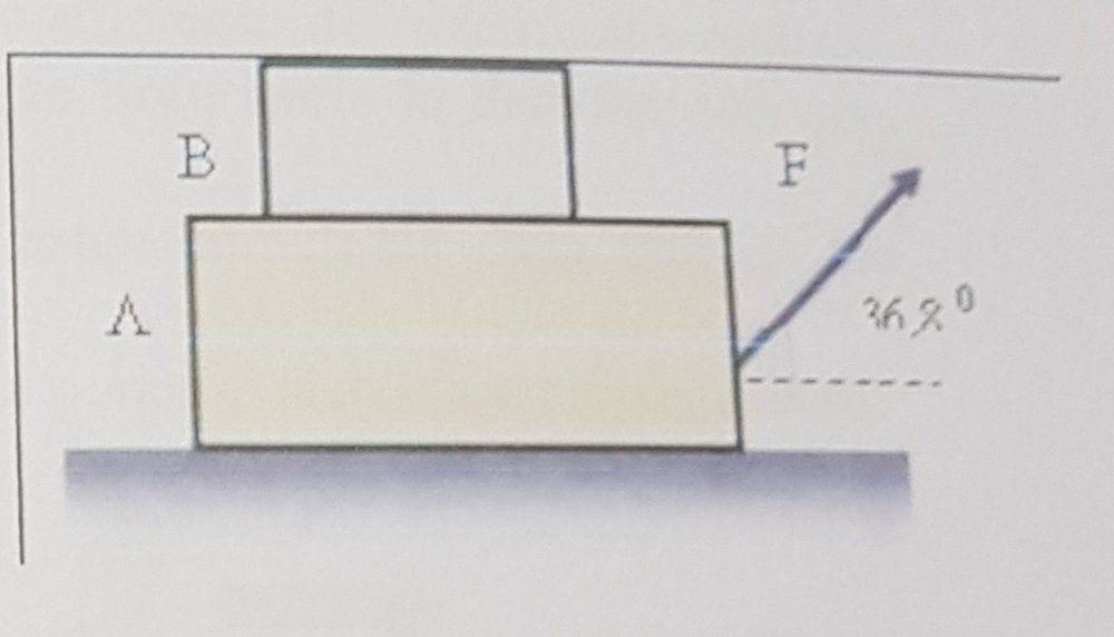

In the picture, the coefficient of static and dynamic friction for all contact surfaces are ##0.4## and ##0.14##, respectively. The mass of ##A## is ##73 kg## and the mass of ##B## is ##22 kg##. Determine the maximum force so that B doesn't slide. Then, suppose that the force applied to the system is greater than the force calculated previously, how much time would it take for the blocks to move ##10 m##?
Newton's equations
Well, I'm having trouble with the free body diagrams. For ##A## we have
##y)## weight, normal force, contact force with ##B##, ##F . sin(36.8°)##. And the acceleration is ##0## because we want to calculate the maximun force before moving.
##\Sigma \vec F = m . a_y##
##\vec N_A + \vec F . sin(36.8°) - \vec W_A -\vec Fc= 0##
##x)## ##F . cos(36.8°)##, friction force with the ground and friction force with ##B## and the acceleration is 0.
##F. cos(36.8°) - Fr - Fr_B=0##
##Fr## and ##Fr_B## have the same direction, don't they? Because the friction with ##B## must be pushing ##B## towards, and then the reaction force is in the opposite direction.
For ##B## we have:
##y)## weight and contact force (normal force)
##\vec N_B - \vec W_B =0##
##x)## friction force with ##A##
But is this force pointing to the right? And then, is the string applying a force on ##B##?And then when I want to answer the second question, do they move equally? I mean, if ##A## traveled ##10 m## so did ##B##

Like Tony Stark said:
normal force, contact force with B
The contact force with B could include a frictional component in general. Better to say normal force from ground, normal force from B.
the acceleration is 0 because we want to calculate the maximun force before moving.
No, it's the maximum force before B slides on A. A will be moving by then.

So the free body diagram for A is
##x) F.cos(36,8°)-Fr-Fr_{AB}=m.a_x##
##y) F.sin(36,8°)+N-P-F_{AB}=m.a_y##
And for B is
##x) Fr_{AB}=m.a_x##
##y) F_{AB}-P=m.a_y##
Is this correct?
And for the ##y)## axis of both bodies the acceleration is equal to 0, isn't it? Because they don't move upwards. Is this right?

Yes, except what is P in these equations? Not the same in both, I assume.
And for the y) axis of both bodies the acceleration is equal to 0
Yes.

Ok, but different weights for the two blocks, right?
Yess
Yess
Ok, so can you solve the equations?
