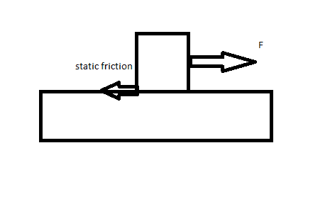

Block of mass m = 0.5kg sits on top of large plate with mass M = 1.5kg. Contact surface of plate and ground is friction less and coefficient of static and kinetic friction is 0.9 and 0.5 respectively. System is originally at rest and external force F(t) = 2t N (where t is time in seconds) is used to pull the block. Until block starts to slide, after which F is maintained at value in part (a). Assume plate is long enough such block doesn't fall off plate.
(a) Calculate external force F at moment before block starts to slide on the plate.
(b) Calculate how far plate will travel relative to ground 1s after block slips.
(c) Calculate how far block travel relative to the ground 1s after it slips.
s=ut+0.5at^2
F=ma
Question as follows:
My answer/explanation:
Force needed to make block slide = static friction between block and plate.
So friction = normal of block * static friction = (0.5∗9.8)∗0.9=4.41N(0.5∗9.8)∗0.9=4.41N
That would be true if the plate were held fixed. But plate and block can accelerate.
Consider the net horizontal force on the block. What equation can you write?
Net force on block = external force - static friction between block and plate ?
I can't seem to figure out how if plate moves in the opposite direction, it will affect the force on the block :(
Right. Now consider acceleration (a) of the block and (b) of the plate.
Acceleration of block = (F-static friction)/mass of block
Acceleration of plate= static friction/mass of plate?
Right. And as long as the block is not sliding on the plate, how can you connect those equations?

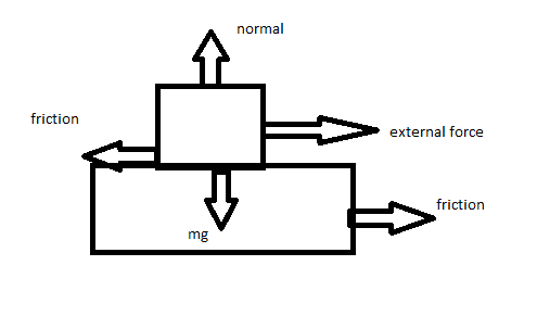

jisbon said:
If block is not sliding, does that mean both block and plate has the same acceleration?
Yes.
haruspex said:
Yes.
Okay, so going back to the question:
So I assume to slide, Acc of block must be more than acc of plate.
So in this case,
[tex] \frac {F-friction} {mass of block} = \frac {friction} {mass of plate+block?} [/tex]
And solve for F?

Hm that's weird let me see again:
So part (a) is:
[tex] \frac {F-friction} {mass of block} = \frac {friction} {mass of plate} [/tex]
Friction = [tex](0.5*9.8)*0.9 = 4.41N [/tex]
So[tex] F = (\frac {friction} {mass of plate} * mass of block) + friction [/tex]
= [tex] (\frac {4.41} {1.5} * 0.5) + 4.41 [/tex]
= 5.88N
Will this be the final answer?
Regarding part b, I think the questions wants the distance traveled during the 1 second after slipping starts. So how should I start? By finding the initial velocity when it starts to slip? Or..? Thanks!
jisbon said:
= 5.88N
Yes.
