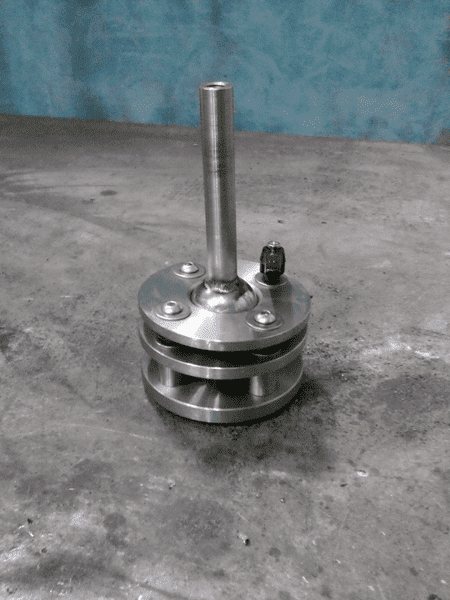

I have found in practice, that a 'hook in a cup' doesn't work, at least, not when made out of thin brass bar. The difference in moment of inertia in the plane of the hook and perpendicular to it was enough to cause the pendulum to trace a lissajous figure, with a cycle time of 60 - 90 minutes, overwhelming the Earth's rotation. Perhaps if the hook were made of a really lightweight material? Or if the pendulum was longer and heavier in relation to the pivot piece (mine is only 1.2 metres long and 1.4 kg).
My solution was to make a 'cage' - think of the 'hook' as being a rectangular 'C' piece, with a downward pointing support from the top, and the pendulum hanging underneath. Now have three 'C' pieces, open ends joined, at 120 degree angles. That has a moment of inertia independent of swing direction (by my calculation) and was necessary to get the pendulum working. The rotation of the cage turned out not to be a problem - it didn't rotate (though it can turn very freely indeed). The swing can go any way without causing the cage to rotate at all. Presumably in an absolutely frictionless pivot, it would rotate too - but my pivot cannot be 'that' frictionless! (a ruby on a piece of glazed china).
The other crucial thing, was a very rigid support bar - even a tiny flex leads to lissajous patterns!

Problem with a small scale version is there are so many more significant factors. Nothing like a cathedral dome to get the job done properly. I was contemplating using the stair well of a 4 storey school building but none of my students at the time fancied it as an A level investigation.

yes - I measured the flex in the support bar, and found it had a spring constant of something like 5600 Newtons per metre (measured with a x400 USB microscope photographing the end of the bar while hanging small weights off it). Worked out that at maximum swing amplitude (3 cm), the pivot would flex sideways by something like 30-40 microns or so. After stiffening the bar, the problem disappeared.
Now its the driver I'm working on - swinging freely, it takes over six hours to decay too much to measure, so easy to observe the correct rotation. But I would like it to run indefinitely. Thinking electrostatics rather than electromagnets, but getting bogged down in the mathematics as I try to figure out equations of motion resulting from a driver that is slightly off centre. I think it might be beyond my current ability. Might need a computer simulation instead.
