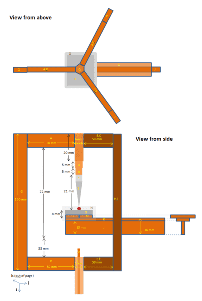

The axes don't rotate. Their directions were tied to the orientation of the pivot bar whose flex was causing the problem. The figure was a straight swing which evolved into a clockwise ellipse, becoming circular before collapsing into the other straight direction - then reversed with a counter-clockwise ellipse back to the original direction. Those directions never moved for a given run. But the angle between those directions could be anything from zero to 90 degrees, depending on the way the swing was started.

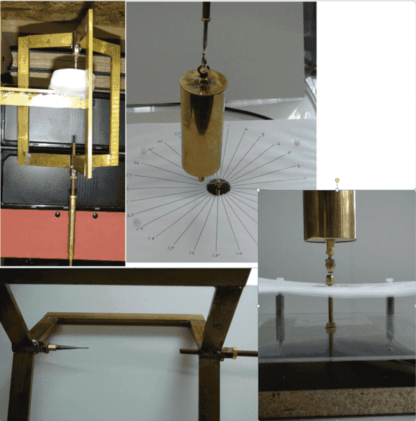

p.s. Could you post a photo of the contraption?
  • #52
Here goes - hopefully it won't be too large for the forum ...
I have more design details - if anyone wants to try to put something like this together and would like more detail, please let me know.
From top left, clockwise
1. The pivot assembly. White 'blob' is polymorph that holds the china platform in place and prevents the pivot from sliding off it. Frame is made from pieces of brass bar cross section 13x3 mm, soldered together with the aid of a small blowtorch. Don't look too closely at the solder quality - I'm used to a soldering iron, not a blowtorch for soldering! Assembly was done with the aid of lots of (now charred) temporary wooden jigs and clamps. The support bar is made from two lengths of bar, one perpendicular to the other, to form a 'T' cross section. This was the stiffening required to remove lissajous figures, after which the pendulum worked. Shaft is 3 mm brass rod, joined with M4 hex standoff nuts with bar soldered into the ends, and with M4 threaded brass rod to provide height adjustment. The ruby probe is one of these : http://www.renishaw.com/shop/Product.aspx?Product=A-5000-7808.
2. The bob, slung on an M4 threaded brass hook screwed into a hex nut on the bottom of the shaft. below is the card marked off in 'hourly' intervals.
3. The base, underneath the card. The driver electrode is screwed into an acrylic sheet, and (not visible) attached to a screened EHT lead going to the power supply. The reason for the long bolt is to get the action point well away from the feeder. Initially, with an unscreened feeder and a short bolt, the pendulum would tend to swing in line with the feeder cable! The bob is a brass-encapsulated lead clock weight with a bolt and domed nut glued to the bottom, matching the driver electrode.
4. The pivot assembly on its own, showing the pivot point. the probe is screwed into an M2 hexagonal nut, which in turn is screwed on to an M2 bolt whose head is soldered to an M4 nut that joins the frame pieces.
This is the schematic from which I constructed the whole thing. The attachment of the ruby probe to the frame is not quite the same as the final device, but otherwise it is accurate.
