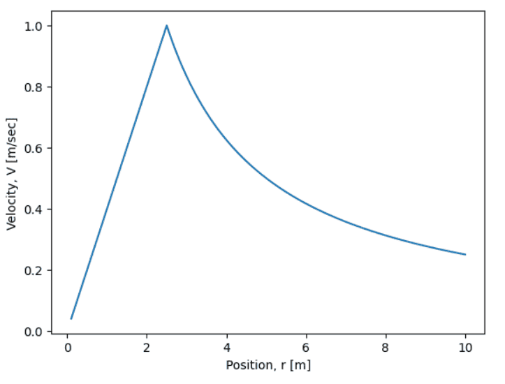

I have a velocity function of radius r, that I would like to write a Fourier Series expansion to approximate.
I have a velocity function U_theta(r), where r is radius from the origin. This function is defined as:
def U_theta(r):
s=2.5
R=1*s
U=1
if r<=R:
U_theta=r*U/R
if r>R:
U_theta=R*U/r
return U_theta
The plot of U_theta as a function of R is shown as:
How can I write a Fourier series to approximate this curve?

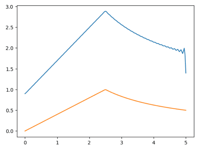

I have a start on this, but am not getting a satisfactory result, as shown below:
My code that does this:
from scipy.integrate import quad
import numpy as np
def U_theta(r):
s=2.5
R=1*s
U=1
if r<=R:
U_theta=r*U/R
if r>R:
U_theta=R*U/r
return U_theta
L=5
def fourier(r):
A0=(1/L)*quad(lambda r: U_theta(r),0,L)[0]
An=0
Bn=0
for n in range(100):
An+=np.cos(n*np.pi*r/L)*(2/L)*quad(lambda r: U_theta(r)*np.cos(n*np.pi*r/L),0,L)[0]
Bn+=np.sin(n*np.pi*r/L)*(2/L)*quad(lambda r: U_theta(r)*np.sin(n*np.pi*r/L),0,L)[0]
return (A0/2)+An+Bn
fourier_x_vals=np.linspace(0,L,200)
fourier_y_vals=fourier(fourier_x_vals)
plt.plot(fourier_x_vals,fourier_y_vals)
U_theta_y_vals=[U_theta(r) for r in fourier_x_vals]
plt.plot(fourier_x_vals,U_theta_y_vals)

Because ##U_\theta(r)## can be extended evenly around ##r=0## (##U_\theta(-r) = U_\theta(r)##), a Fourier cosine series is used. This means sine terms are zero (##B_n = 0##).
We work on ##[0, L]##, with ##L## significantly larger than ##R## (e.g., ##L = 4R##, ##5R##, or ##10R##).
The Fourier cosine series is:
$$U_\theta(r) \approx \frac{a_0}{2} + \sum_{n=1}^{\infty} a_n \cos(\frac{n \pi r}{L})$$
The coefficients are:
$$a_0 = \frac{2}{L} \int_0^L U_\theta(r) dr$$
$$a_n = \frac{2}{L} \int_0^L U_\theta(r)\cos(\frac{n \pi r}{L})dr$$
We split the integrals:
* From ##0## to ##R##: ##U_\theta(r) = \frac{r}{R}## (since ##U=1##).
$$I_1 = \int_0^R \frac{r}{R}\cos(\frac{n\pi r}{L})dr$$
* From ##R## to ##L##: ##U_\theta(r) = \frac{R}{r}##.
$$I_2 = \int_R^L \frac{R}{r}\cos(\frac{n\pi r}{L})dr$$
These are solved exactly. ##I_1## uses integration by parts. ##I_2## involves ##Ci(x) = -\int_x^\infty \frac{\cos t}{t} dt##:
$$I_1 = \frac{L^2}{R(n\pi)^2}(\cos(\frac{n\pi R}{L}) - 1) + \frac{L}{n\pi}\sin(\frac{n\pi R}{L})$$
$$I_2 = R[\text{Ci}(n\pi) - \text{Ci}(\frac{n\pi R}{L})]$$
For ##n \ge 1##:
$$a_n = \frac{2}{L} (I_1 + I_2) = \frac{2L}{(n\pi)^2 R}(\cos(\frac{n\pi R}{L}) - 1) + \frac{2}{n\pi}\sin(\frac{n\pi R}{L}) + \frac{2R}{L}[\text{Ci}(n\pi) - \text{Ci}(\frac{n\pi R}{L})]$$
For ##n=0##:
$$a_0 = \frac{2}{L} \int_0^L U_\theta(r)dr = \frac{R}{L}(1 + 2\ln(\frac{L}{R}))$$
, giving a constant term of ##\frac{a_0}{2}##. The ##a_n## values decay as ##1/n^2##.
