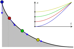

Technically, the mass of Earth and slide should be included in conservation of mechanical energy in either frame (closed system free from external forces). From a frame where the Earth and box are not initially moving, v0 = 0, then vfearth will be slightly below 0 (slightly negative) and vfbox will be slightly below ##\sqrt{2 \ g \ h}##. Since the Earth is much more massive than the box, the box gets most of the increase in kinetic energy.
From the skateboarders frame, v0 will be slightly above (less magnitude) ##-\sqrt{2 \ g \ h}## and vfearth will be slightly below (more magnitude) ##-\sqrt{2 \ g \ h}## . In this frame, the Earth gains kinetic energy, while the box loses kinetic energy.
The problem is similar to a box sliding down a frictionless wedge on a horizontal frictionless surface, except in this case the mass of the wedge (earth + slide) is huge.
Likes A.T. and ObjectivelyRational
I kind of agree with rcgldr:
Kuruman states:
"It should be clear to the reader that in either reference frame momentum and energy conservation gives the exact solution while energy conservation only results in an approximation, albeit a good one."
What happens if you include the kinetic energy of the Earth in the energy conservation calculations?
As usual, the apparent paradox is much easier to understand when analyzed using the action principle. In the original frame we have
$$L=\frac{m}{2} \dot{\vec{x}}^2-mgy,$$
where ##y## points vertically up. Further we have the holonomous constraint
$$y=f(x)$$
and thus the action reads
$$L=\frac{m}{2} [1+f^{\prime 2}(x)] \dot{x}^2-mgf(x).$$
Now it's clear, why seen from the skater's reference frame the energy is not conserved. We have
$$x=x'+u t, \quad y=y'$$
and thus
$$L=\frac{m}{2} [1+f^{\prime 2}(x'+u t)](\dot{x}'+u)^2-mgf(x'+ut).$$
Since now the Lagrangian is explicitly time dependent, energy is no longer conserved from the skater's point of view.
The simple approach in the ramp's frame is not based on the conservation of total energy, just on the work theorem applied to the block: Since the ramp does no work on the block, the block's energy should be constant.
However, this assumes that the ramp's frame is inertial, which it actually isn't as the lack of momentum conservation shows. So even if the ramp does no work on the block in the ramp's frame, the inertial force present in that non-inertial frame does a tiny bit of work on the block.

This is a good insight. An important point is that we tend to see the universal gravitational field as allowing us to apply the Galilean transformation. If the problem concerned a pendulum the answer would be simpler to see. A pendulum, for example, analysed in a frame where the fixed point is moving can't obey the conservation of mechanical energy.
We could also consider an observer moving vertically when an object is dropped. Again, it's clear that mechanical energy cannot be conserved in the moving frame. E.g. The observer could be moving down at the final speed of the object, hence the object ends up with zero KE in the moving frame. In this case, the observer could calculate the vertical displacement in his reference frame, not in the Earth's frame, and that should sort the energy equation.
We have a special case, therefore, that when the force is vertical and the moving reference frame is horizontal, then the vertical displacement in the two frames is the same. The mistake is to generalise this special case.
Another way to look at this problem is to say that first in the Earth frame the gravitational force is partially opposed by a normal force, so the nett (gravitational) force is tangential to the slope. We could imagine that this is the only force we have.
Then, we can resolve this nett tangential force into horizontal and vertical components. The vertical component is no problem for a reference frame moving horizontally, but the horizontal component is a problem if you try to model it as a distance-based potential.
