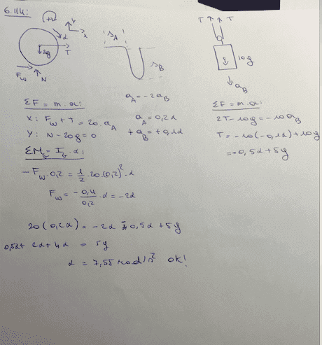

I am an electromechanical engineering student. The last few days I am trapping into some confusion about some things. I am just going to state my question underneath.
Question:
First question:
As they learned me at the university. When you draw a free body diagram it doesn't mind in which direction you draw a force. In the end, you get the same magnitude but with a different sign, what means that the force will be pointing in the opposite direction. This is correct?
For example the exercise below. What if a drew the N-force in the opposite direction? Would it give me the same numeric solution but with a different sign? For my experience, the angular acceleration that i had to calculate was a different numeric solution when I had drew the N-force in the opposite direction.
For example I had to calculate the angular acceleration. I drew the N-force counter the y-axis. So the equation would be: -N - 20*g = 0 <=> N = -20*g ! This means I have drawn my force in the wrong direction. Do I have to change the value to N= 200 N or do I have to calculate with the N = -200 N until the end when the exercise is done? (and use the - 200N in momentum equations for example).

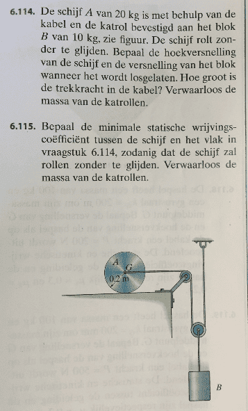

When having a dynamic or static problem. Take for example a dynamic problem. Like underneath:
The exercise is written in dutch, sorry for this.
This is my solution:

Thanks for your reply. Sorry I didn't use the template, will do it in the future!
1) When: positive direction (up/y) and positive direction (right/x). Imagine I am searching the N-force. I don't know the direction (down or up).
The equation will be: -N - 25*g = 0 (imagine I drew the N force down in negative direction) solving will give: N = -25*g. So far, this means that the force will be pointing up and not down (because of the negative sign). Does it matter in which direction I draw an unknow force (in all cases)? And what if I find out in an exercise that my force is drawn in the wrong direction. Do I have to calculate with the N = -25*g till the end of the exercise or do I have to use N = 25*g in further calculations during the exercise?
2) The disk has a no-slip condition. The acceleration (a) is pointing to the right (positive x direction). My angular acceleration MUST be clockwise? (otherwise there would be slip...). Is this correct? Extra question: what if I don't know if there is slip/no-slip...
So far I the case of the no-slip condition. Imagine I draw the angular acceleration in counter clockwise direction and the acceleration (a) in the positive x direction.
Would my calculations point out I drew the angular acceleration in the wrong direction? (will my result be negative...?)
Thanks!
1)
Yes, that is ##\sum \vec F = 0##. You adopted ##y^+## is up, so ##\vec g = (0, -9.81) ## m/s2 . For the y components ##\sum \vec F = 0 \Rightarrow \vec N_y - 9.81 m = 0 ## ( I use ##\vec N_y## for the y component of ##\vec N##). Outcome: ##\vec N_y = 9.81 m ## Newton. A positive value, so pointing upwards.
You use the letter N for the vertical component in downward direction and compensate by writing a minus sign in front.
And you do the same with mg.
It's OK, but you risk confusion, of course. Either way you get ##\vec N = -m\vec g##.
Most of the times the cause of confusion is in the symbol for g. Some people understand intuitively where to use a minus sign and where not. When you use ##\vec g## that is more unambiguous.
2)
The no-slip condition means that the point P on the rim that touches the table does not have a horizontal velocity component ##\vec v_{P, x}##.
With $$0 = \vec v_{P, x} = \vec v_{{\rm c.o.m.}, x} + (\vec \omega \times \vec r_P)_x $$ you get $$
0 = \vec v_{{\rm c.o.m.}, x} - \vec \omega_z \;\vec r_{P,y} $$ Now, ##\vec r_{P,y} ## is negative so that the z component of ##\vec \omega## comes out negative too: it points into the paper away from you. Corresponding to clockwise in the drawing. And likewise ##\vec a## and ##\vec \alpha##.
The magnitude of a vector is always positive. When you prefix a vector with a plus/minus sign, it just connotes the sense of the vector (right/left, up/down, forward/backward). This converts parallel vectors to scalars so you can manipulate them with algebraic addition.
Alternatively, you can arbitrarily assign a positive sense to all vectors, and then you would follow the rules of vector addition.
With angular acceleration vectors, there is no obvious sense so you use the right-hand rule or some similar convention.
