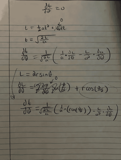

I've gotten homework relating to proving that at any angle, freefalling through the earth will take the same amount of time.
L = 2rsin(θ) (chord length)
I haven't really attempted anything worth showing on the calculus side

I am sure you can think of more relevant equations. How about something concerning gravity and (uniform) spheres?

Your second equation is a SUVAT equation. They assume constant acceleration.

When it is at distance x from the midpoint of the shaft, what are the forces on it?
What acceleration will that produce?

the forces would just be gravity(and normal force perpendicular to the chord) gravity would just be linear so (dist from center)/R * weight(at surface). To get an eq relating gravitational force towards the center with force parallel to the chord would require both time and dist which would have to be related seperately right?

If at distance r from the Earth's centre and distance x from the midpoint of the shaft, what is the acceleration along the shaft?

force of gravity towards the center would be (r/R(radius of earth))*weight. Angle of Fg would be θx/2rsin(θ/2), so force parallel to chord would be w(r/R)*sin(θx/2rsin(θ/2)). Then plug in to f=ma
That's a very strange formula.
Is that ##\theta## still how you defined it in post #1?
If so, ignore that angle and consider the angle between the distances x and r. Call that ##\phi##. What fraction of ##F_g## acts along x?

I mistypes in the first post. it should be L = 2rsin(θ/2). I got the angle by finding the fraction of the total chord length x is, and then multiplying that with the central angle

cos(θ) of Fg

As I wrote, forget about the angle the entire chord subtends at the centre. Concentrate on the angle between r (not R) and x. If the gravitational force acts along r, what fraction of it acts along x?

cos(theta) of Fg. Is there any way I could see a reference for this proof bc I feel like this convo is going to take a while with the responses. I can ask you about the reference too, but I feel like I'd learn much better with it.

Where theta is what, now? If the angle between x and r, yes.

the only way i see to derive that theta(angles between x and r) is with the angle I mentioned previously, but by subtracting it from 90deg. So theta =90-(θx/2rsin(θ/2)). I don't understand how to get it without the central angle

You have a right angled triangle where r is the hypotenuse and x is the "adjacent " and (this) theta is the angle between them. What equation relates them?
arccos(x/r)=theta
cos(theta)=x/r
achap01 said:
arccos(x/r)=theta
cos(theta)=x/r
Right, so express the component of the gravitational force along x in terms of x and r.
cos(arccos(x/r))
= x/r

I go to 9.8/R=a but i dont know what to do now
That is dimensionally wrong, so cannot be right.
There should be an x in there. Check your working. If you can’t find the error, post it.

sorry i mean 9.8x/R=a

Ok, nearly there!
So write the differential equation relating ##x## to ##\ddot x##.
But it is better to leave it as "g". If you substitute a numeric value you should include units.

would ẍ just be the second derivative of x with respect to time, so ẍ=a=9.8x/R?

Almost, but watch the signs. If we take x as going from ##x=-L## to ##x=+L## then when ##x<0## the acceleration is positive. Correcting that, do you recognise the form of the ODE?
Please use "g", not "9.8".
