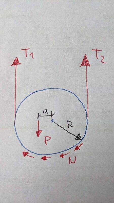

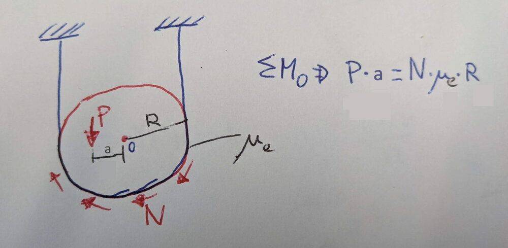

We have a cylinder held by a rope . The rope holds it around its lower half.
If the center of mass of the cylinder is not in the middle, but towards a side, a distance "a". How does this offset affect to the friction on the rope?
or
How big does "a" have to be so the cylinder starts moving?
The weight of the cylinder "P" goes downwards. But the friction is along the lower half of it. Can one sum the moments around the center?
P*a=N*mue*R {1}
N: reaction force along the rope
mue: static friction coeficient
R: cylinder radius
In general:
P=mue*N {2}
I can't combine these two
How can I calculate "a"?
thanks

There are 4 forces: the two tensions (T1, T2), the friction (N) and the weight (P)
How can I connect them? I can't say that the sum of forces in the vertical axis is zero. N is changing direction

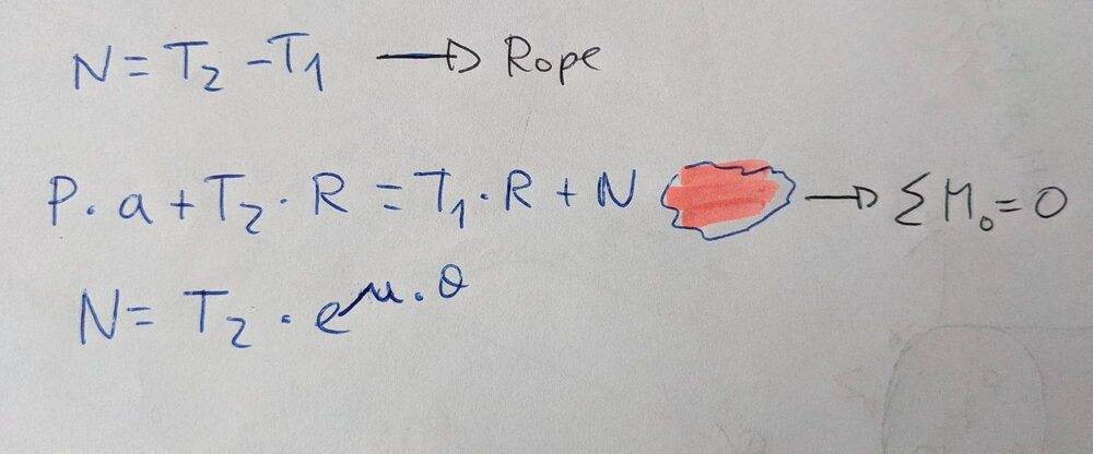

Such
T2 = N + T1
This is one equation on the rope
Then we have the
N = T2 * e^(mu*theta)
And finally the moments around the center:
P * a + T2 * R = T1 * R + N (xxxx)
I don't know how N contributes in the formula. I am guessing N * R * theta (the force along its contact line times the distance to the center)

Note that as distance a gets bigger, two things also grow: the value of the moment excerted by off-center force P and the difference between tensions of the the rope.
In real life, force P would move the cylinder in the diagram towards the right some, as a state of static balance appears.

I agree with the use of the capstan equation. I disagree that there will be any rightward slant. Consider that in a state of static equilibrium if both tensions had a rightward component and the downward force of gravity were still purely vertical, this would give a net rightward force, contradicting the claim that we have a static equilibrium.

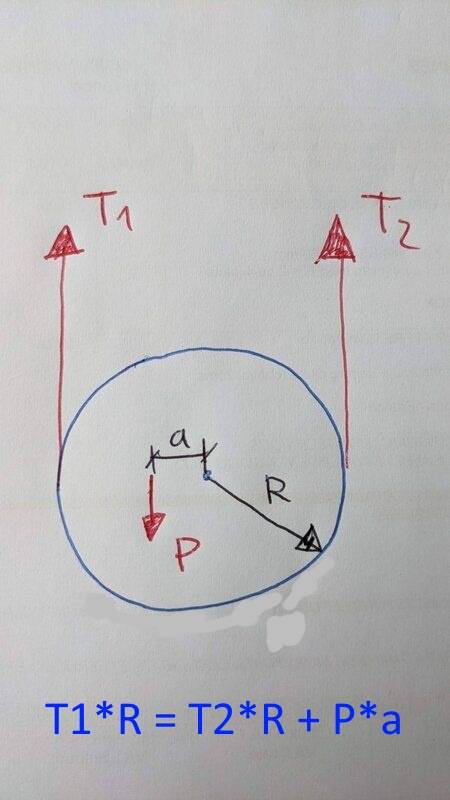

It is most convenient to pretend that the section of cord between the two attachment points is part and parcel of the cylinder. That segment will be negligibly massive and will move with the cylinder, so this interpretation does not change the problem in any meaningful way.
[You use the capstan equation to determine the ratio of the tensions first, then apply this re-interpretation].
With this new interpretation in hand, the cylinder is subject to three external forces and friction is no longer relevant.
ok!
So sum of moments respect to the center and I already have it.
Like this:
or just sum of forces in the vertical direction:
T1 + T2 = P
