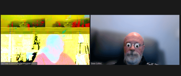

So, this a screen cap from my lappy when zooming.
She says it starts off OK, then does this for a few minutes then goes back to being fine for a few minutes.
Notice the ghost images of a crotchety old man in the top of the image on the left.

Since it started a few days back, I suspect it can be a driver issue. Windows updated itself automatically, and the updated driver for the camera was buggy.
Are you using the Zoom app on Windows? If yes, can you try re-installing it?
The camera app should also allow recording video. Can you record a video on her laptop for a sufficient length of time and see if this happens? The camera could start off fine, but the problem may start after some time, especially if the video is being recorded or broadcasted.

Looks like a software/driver problem to me: there's no way even a broken camera can distort an image that is not coming through the lens. Sony has not made a VAIO for years, is this one of these threads where it turns out after a couple of dozen posts that you are running a bootlegged copy of Windows 3.1 or something?
I was thinking an overheating or failing chip.

I think you are using the Zoom Windows app. Even though the meeting is launched from the browser, it's not working in the browser; the browser just launches the Zoom app.
Can you please try and report the following:
1. Can you set up one more Zoom call, and this time, forcibly use the Zoom web client on the problematic laptop? To do this, when the pop-up shows up in the browser, you have to "Cancel" it and click "Join from your browser" link at the bottom of the page. See this page (bookmarked link) for the instructions: https://support.zoom.us/hc/en-us/ar...-Zoom-web-client#h_01FGW753J4PVWY94DCEQQTAQ1Q
2. Could you reproduce the problem while recording a video through the webcam for a sufficient time period?​
3. I am sure you guys have Google accounts. Can you set up a Google Meet session on both of your laptops and see if the issue can be reproduced?​
This way, we can understand whether the issue is only in the Zoom app, or system-wide.

OK, just did that. I installed the Monitoring extension and left it open.
She hosts meetings via a company account setup in E*ge so I had to make a new account via Chrome.
The moment I started to host a new meeting - even before I had a chance to invite myself - her video came up corrupt on her own screen. Chrome told me there was zero interruptions and 100% connectivity and everything else was green across the board.
After about 30 seconds her video simply righted itself.
I just checked again, after about two minutes and it's back to corrupt (essentially colour-inverted). Still zero interrupts, latency 30ms.
There's a running real-time graph that's labeled "online/offline" with a 0-100 scale (as if one can be, like 57% online?) and it wanders between 20% and 80%.
