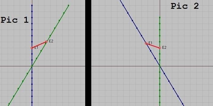

I can 'understand' that picture above about violated causality if one of the party is moving.
Is there an example about violating causality if one of the party is NOT moving?
Thank you very much.
In relativity there is no such thing as "not moving".
I mean if Party A and B are co moving. Their distance is the same all the time. So if A sends an FTL signal to B and B replies, there's no causality violation?
[EDIT: Party A and B are co moving]
If all FTL signals are FTL in one given frame, you will not have causality violations. You need FTL signals in at least two frames to produce causality violation - because one of them is then time reversed in the other frame. If you posit FTL signals that violate Lorentz invariance (e.g. there is a preferred frame in which you can send signals any direction and speed, but in other frames you cannot), then you can avoid causality violations.

So concerning this picture again.
This the ST diagram for someone (red) who sends FTL signal to the other party (blue) who is moving relatif to red.
But it doesn't have to be signal and parties, right?
It could be a very fast rocket who travels from red, and at some point it slows down so its relative speed to (supposed) red (party) is say,... 0.6c then it travels back to red?
Then if the rocket travels FTL, when the rocket arrive back at spot Red, it will be at red spot wordline in the past?

Yes, if a rocket could somehow travel FTL in two different frames, it could end up in the causal past of where it started.

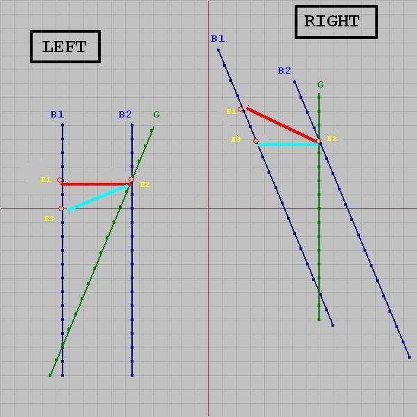

Dear PF Forum,
I'm sorry if I ask again.
I still don't understand about this causality violation.
There are three parties: Blue, Blue, Green
B1, B2 and G.
B1 and B2 are co moving.
G travels at v.
The speed of FTL signal is instaneous
Please consider the left diagram
1: At E2, if B2 sends an FTL signal to B1, when/when will the signal arrive at?
A: E1?
B: E3?
Please consider the right diagram
2. At F2, if G sends an FTL signal to B1, when/where will the signal arrive at?
A: F1?
B: F3?
Left:
3. At E2, there's an FTL signal (never mind who sends it) travels to B1, when/where will the signal arrive at?
A: E1
B: E3
Right.
4. At F2, an FTL signal travels to B1, when/where will the signal arrive at?
A: F1
B: F3.
This SR things really confuses me. Perhaps if I'm given a simple answer, I will take the conclusion myself.

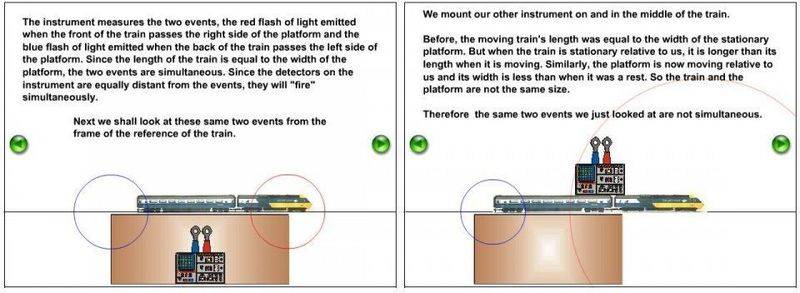

This is the train - platform animation.
In this example, there are two answers. Both train and platform don't agree about event red and blue. But there is only one signal (RED) that arrives in the middle of the train, and one signal (BLUE) that arrives in the middle of the train. This at least I can "understand" (or grab)
But in those FTL example, there will be two signals?
One arrives at B1 "now", and the other one arrives at B1 "past",
A: E1?
B: E3?
It really depends on your model of FTL - which, since there is no hint of it, all theories about it are speculation. Going with what seems to be your model, clarified: an FTL signal travels on the spacelike geodesic 4-orthgonal to the emitter's world line at the point of emission. Then B2's signal would arrive at E1. G's signal emitted at the same place and time would arrive at E3. This is because B2 and G are in relative motion, so their FTL signals travel on different spacetime paths.
A: F1?
B: F3?
per the theory under consideration, at F3.
Stephanus said:
Left:
A: E1
B: E3
You can't say 'never mind who sends it'. Because "travels spatial distance instantly" is a frame dependent statement. My formalization of your model effectively states that this statement is (travels instanty) is true in the rest frame of the emitter. Thus the emitter must be specified and is crucial. Thus this question is counterfactual - even to your proposed model, ant the possible questions have been answered in (1) and (2).
Stephanus said:
Right.
A: F1
B: F3.
Same answer as for (3).
There can't be FTL signal. But if there is, I'd like to know how it is impossible.View attachment 95144
What I want to know in this post is this:
5: Not that FTL CAN send signal in the past, but will there be two reply signals if we send FTL signal?
Not in the proposed model - the spacetime paths of FTL signals depend on the rest frame of the emitter.

I'm sorry. Hevan't I said that my FTL is instaneous?
Thank you very much PAllen.
Yes. The problem is that this means that the emission and reception events are simultaneous. But simultaneous according to who? You haven't answered that, and that there is no obvious answer to that question is basically why we assume it's impossible. PAllen has provided two sensible answers. One is in #4, where he allows simultaneous communication in one frame only, which is to say that there is one frame in which communication is instantaneous independent of the motion of the emitter. This does not allow causality violations because all FTL communication is represented as parallel lines on the Minkowski diagram. Even though I can receive your message before you sent it in some frames, my reply must be sent after I received it and the parallel lines requirement means that you must receive it after your initial sending. However, we've picked one frame out as special, which is not a very comfortable thing to do in relativity.
The other model he suggests is in #8 where he says the emission and receipt is simultaneous in the rest frame of the emitter. This can lead to paradoxes since the worldline of my reply can cross your original signal and arrive at you before you sent your original signal.
Which of these models you choose to apply is up to you. There's no evidence of the actual existence of FTL communication from which to be able to make any kind of real decision.
