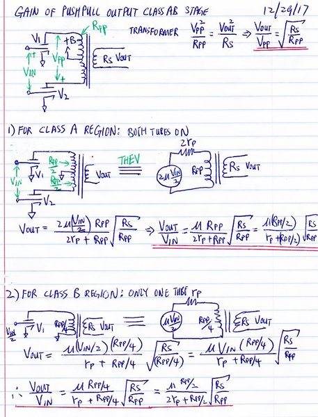

I don't know if anyone here design tube power amps. I am calculating the gain of the class AB output stage of push pull tubes and output transformer. Class AB by definition has a small signal region that both tubes are working and is operating in pure class A. Only when input signal is large to a certain point when one or the other tube is turned off and the stage goes into class B region.
I have trouble proofing the gain of the class A region is the same as class B region in the output stage. That would not be good as the gain changes from small signal to large signal. Here is my derivation of gain of both class A and class B. The article I use is:https://pearl-hifi.com/06_Lit_Archive/07_Misc_Downloads/Push_Pull_Theory_MIT.pdf Fig.33b. for class A calculation. For class B, one tube is off, so the one tube that is working sees the primary impedance of Rpp/4. I showed the calculation of both and you can see the equation do not match. I would like someone with this knowledge to take a look.

I'm not sure what some of the subscripts here mean so it is a bit difficult to follow your math. The gain of a push pull stage is difficult to calculate in full generality since the load line is not a smooth function when transitioning from class A to class B. So I am suspicious whether or not the formulas you have describe AB operation.
In my experience, calculating the exact gain is not feasible anyways because both tubes and transformers have strong non-ideal behavior. I usually just try to find a rough estimate of the gain. For a power output stage, I usually expect a gain of around 6 or so.
Since I'm not a fan of drawing composite curves, I tend to follow the method suggested here for calculating the gain http://www.valvewizard.co.uk/pp.html. This is certainly not exact, but it is simple and will give you a reasonable estimate of the gain of a push pull stage.

I read the article from Valve Wizard many times and I drew the load line for my design using their technique of drawing the class A and class B load line. But that's not exact. ( I know nothing is exact in tubes, but the gain has to be the same before or after the transition from class A to B, or else, the distortion will be substantial.) I just cannot see the gain is different between class A and B. But I worked on this for a while already. I am just hoping someone have better insight than me.
Actually my derivation is very much follow the Valve Wizard article, that separate the class A from class B like the two load lines drawn. ( the composite load line is just the class B load line where the primary impedance of the output transformer is Rpp/4... or in the Valve Wizard Za/4)

During class A operation is where there will likely be some deviations. Notice how the composite curves in class A don't intersect. I don't expect the deviation to be large from class A to B, but it is there. During class B operation, the gain should be close to what you have drawn, since only one valve is turned on.
If you are building a push-pull output stage, my best advice is to follow these composite curves that you have drawn. Once the circuit is built, you can use an oscilloscope to fine tune the bias of the output stage to minimize crossover distortion.
I know about approximation and tweaking, what I am trying to do here is trying to analyze what's going on.
I since did the calculation using current source and voltage source to replace the tube, the gains are not equal between class A and class B region. I am just surprised.

I since looked deeper, I wrote out equations for 3 cases, 1) plate resistance equal very high, 2) plate resistance equal 0, 3) plate resistance equal Rpp/2
You can see the gain of class A and B match if rp=0.
I understand that tubes are no linear, gm increase with higher current, the real change is gradual, not abrupt. I just want to examine how the circuit behaves. NFB will help, but it's not a good practice to use NFB to hide problems, NFB is more like the final touch when the circuit is already optimized before the NFB.
At this point, I think I got the answer to my original question using the 3 cases of rp. Part of the problem is also the output transformer acts as autotransformer in class A. Primary resistance change from Rpp/2 in class A for each tube to Rpp/4 when one tube turns off.
