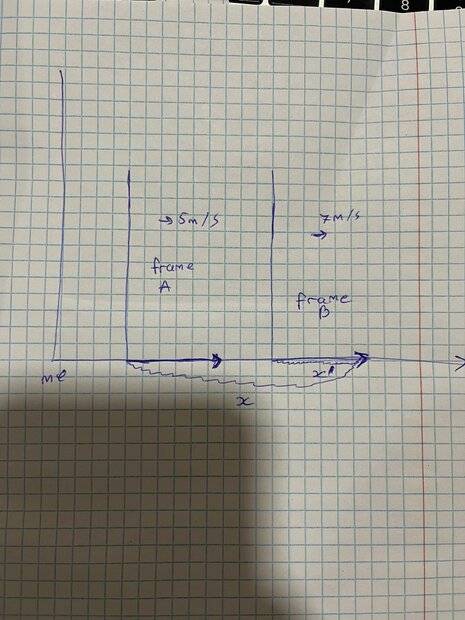

Learning Galilean transformation and just want to see if I understand the concept well.
both frames are moving relative to some other frame(me standing all the time, not moving). frame A moving 5m/s, frame B moving 7m/s, which in turn means frame B moving 2m/s relative to frame A. Galilleo says: x=x′+vt. As far as I understand, x′ coordinates starts from frame B and x starts from frame A(and not from my origin - I'm standing). This means that frame B's object is always at x′=0 in its own frame, whereas frame A's object is at x=0 in its own respective frame. The distance between the objects is definitely vt. Also x coordinate system goes and even covers x′ coordinate system. We can also choose some point in frame B which's coordinat will be x′ in its own frame and x from frame A. Then we can write x=x′+vt.
Including the image ! I just want to see whether my 2 statements are correct.
* that if 2 frames are moving, in the real world case, this means 2 objects are moving relative to each other and their coordinates in their own frames always will be 0. It's just gallilean's formula is much more general and choosing some other points in the frame B for example.
* If x coordinate starts from frame A as shown on the image.

I think you have the right idea. A reference frame is essentially a system of coordinates. The principle of relativity says that the laws of physics are valid in all inertial reference frames. And, inertial reference frames differ from each other in terms of a uniform velocity between them. Also, generally we take the origin of the reference frames to coincide at time ##t =0##.
That means that if ##A## and ##B## are inertial reference frames, then (for some velocity ##v##):
$$x_A = x_B + vt$$where ##t= t_A = t_B## is the common time coordinate.
Now, for an object moving inertially, we can find define an inertial reference frame where the object remains at the origin. This is often described as the "rest frame" of the object. That said, once you have a specific object at the origin of a reference frame, you need to potentially allow an offset at time ##t = 0##:
$$x_A = x_0 + x_B + vt$$Because ##A## and ##B## may not be at the same place at ##t = 0##.

Thanks for the great analysis.
Whats the thing that seems wrong in my statements or in my image ? Just making sure I dont miss something

There was nothing wrong. You don't need a third, baseline frame (your "me" frame). And, just to clarify the relationship between reference frames and objects. Note that several objects all at rest relative to each other share a rest frame (in one sense), but they can't all be at the origin. You just need to note that.
I think this is an example of the 2 frames moving at the same speed where frames’ origins are not the same. In my image, if frame A and B moving at the same speed then we can say they are at rest. But In that case, v would be 0. And x would be equal to x’ which would not be the case as they are separated by some distance from the beginning. I think you meant something else which I dont think I understood but is it that important ? I mean in my examples, if v=0 then the only time galilean works is if from the beginning, frames started at the same origin.
More generally ##x' = x_0 + x + vt##. You can't in general ignore the ##x_0##. Only in cases where the origins coincide at ##t = 0##.
