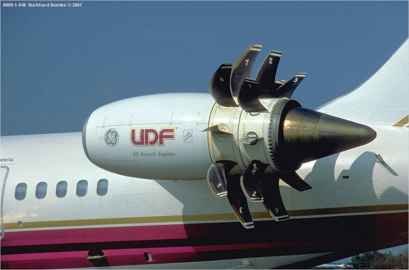

That obviously doesm't work for a helicopter, beacuse the fuselage is the wrong shape to generate aerodynamic lift. Maybe the OP is still trying to make something like these "whirling bananas" into a marketable product. (It worked, but no airlines were brave enough to buy it).
http://www.b-domke.de/AviationImages/Rarebird/Images/0809.jpg
Well, it wasn't just a matter of airline bravery - it had significant issues meeting noise regulations, and the propulsive efficiency gained was somewhat offset by the fact that the large diameter of the engines doesn't allow them to be easily mounted under the wings like most normal jet engines (which is a more structurally efficient placement for a large aircraft).
Indeed - it proved that even a company like GE isn't clever enough to change the laws of physics.
It's a seductive idea though. All the "big three" engine makers have played with variations on it, with a commercial success rate of 0 out of 3 so far.
