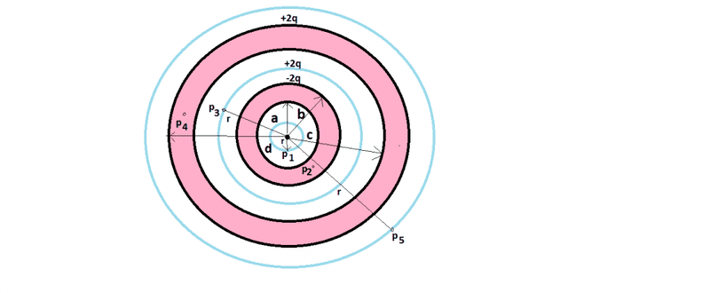

A small conducting spherical shell with inner radius a and outer radius b is concentric with a larger conducting spherical shell with inner radius c and outer radius d. The inner shell has total charge -2q and the outer shell has charge +4q.
a) calculate the electric field (magnitude and direction) in termsof q and the distance r from the common center of the 2 shells fori) r<a; ii) a<r<b; iii) b<r<c; iv) c<r<d; v)r>d.
b) what is the total charge on the i) inner surface of the smallshell; ii) outer surface of the small shell; iii) inner surface of the large shell; iv) outer surface of the large shell.
E.4πr^2=q/ε0
[/B]
This is drawn in my textbook
I have following doubts
1)why charge +4q is distributed /splitted in such a manner i.e +2q &+2q and then why one +2q is put in the circle of inner radius c and one +2q is placed in the circle of inner radius of d.
2)what is the difference between the positions p3 and p4 because my textbook states at P3 electric field would have some magnitude but at P4 electric field would be zero because it lies inside the conductor then why P3 is not considered to be inside the conductor?
Let me start by saying the innermost cavity with radius ##a## is going to have zero enclosed charged, and therefore the electric field is zero inside of the cavity.
Now, what about between ##a## and ##b##? Remember the charge is distributing itself uniformly across the outer surface of the inner conductor.
Then the diagram indicates a ##-2 q## charge on the outside of the innermost shell and a ##+2 q## charge on the inside of the outermost shell. This indicates an electric field that points from the inside of the outermost shell to the outside of the innermost shell. You may use Gauss' law to find ##\vec E##.
Now what is the electric field between ##c## and ##d##? Hint: Think about the field between ##a## and ##b##.
Finally, the outermost shell has a ##+2 q## charge on its surface, and therefore the electric field points radially outward from the sphere. Use Gauss' law to find the electric field once again.
Well for one, the two points are at different locations. The electric field at ##P3## is due to the opposing charges on the inside of the outer conductor and outside of the inner conductor. There must be an electric field at ##P3## as a result, whereas at ##P4## the electric field should be zero because you are on the conductor itself. ##P3## is not inside a conductor because it is outside the inner conductor which has a charge on its surface and ##P3## is inside the outer conductor which also has a charge on its inner surface.

Such charge redistribution for the larger sphere is required to satisfy the requirement that the electric field inside a conductor must be zero. In order to have ##E=0## for ##c<r<d##, the net charge enclosed by a spherical surface with radius ##r## with ##c<r<d## must be zero. Since you already have ##-2q## total charge from the small sphere, you need ##+2q## to be placed on the inner surface of the large sphere. You are left with the remaining ##+2q## in the large sphere and these charges must reside on the outer surface for the same reason as above, ##E=0## inside any conductor.

Imagine a Gaussian surface inside (within the material) the outer conductor (intersecting P4). What's the field over that Gaussian surface? Apply Gauss' law.
Likes gracy
zero.electric field inside the conductor (here gaussian surface) is zero.
Good. So what must the total charge enclosed by that surface be?
Likes gracy
zero.
gracy said:
zero.
Good. So what's the total charge on the inner conductor? Given that, what must be the charge on the inner surface of the outer conductor to cancel it?
Likes gracy

blue_leaf77 said:
the net charge enclosed by a spherical surface with radius rr with c<r<dc must be zero. Since you already have −2qtotal charge from the small sphere, you need +2q to be placed on the inner surface of the large sphere. You are left with the remaining +2q in the large sphere and these charges must reside on the outer surface for the same reason as above, E=0 inside any conductor.
Got your points.Thanks @Doc Al & @blue_leaf77

Let me ask you this, what expression did you get for the E field for ##b<r<c##?
Likes gracy
The enclosed charge itself between ##b## and ##c## is?
blue_leaf77 said:
what expression did you get for the E field for b<r<cb
you mean for P3?It is E=-2q/4πε0r^2
Zondrina said:
The enclosed charge itself between bb and cc is?
zero.
Yes. So what will you get after setting r=b and r=c?
But for b &c E is zero.

This is an example of boundary condition for the normal components of electric field. Mathematically, it has the form of
E_{1\perp}-E_{2\perp} = \frac{\sigma}{\epsilon_0}
where there is surface charge density, the normal components of the E field in the media separated by the surface undergo discontinuity.

That equation physically means that if in the interface between two media there is surface charge density ##\sigma##, the electric field components perpendicular to this interface in the two media separated are discontinuous by the amount ##\sigma/\epsilon_0##. Let's take an example for the spherical surface of radius ##b## in your problem. This surface separates the conducting medium below (##r<b##) and the vacuum outside (##r>b##). This spherical surface also carries a surface charge density of
\sigma = \frac{-2q}{Area\hspace{1mm}of\hspace{1mm} the\hspace{1mm} surface} = \frac{-2q}{4\pi b^2}
We know that the field in immediately below the surface is zero since it's inside the a conductor, so ##E_{1\perp}=0##. The perpendicular component of the field immediately outside our spherical surface is then
E_{2\perp} = E_{1\perp} - \frac{\sigma}{\epsilon_0} = 0 - \frac{-2q}{4\pi \epsilon_0 b^2} = \frac{2q}{4\pi \epsilon_0 b^2}
But since the E field vector itself in our problem is perpendicular on our spherical surface, we have that ##E(b) = E_{2\perp} = \frac{2q}{4\pi \epsilon_0 b^2}##.

But It is (negative) -2q/4πϵ0b^2 in the graph.
  • #33
So it's a matter of interpreting blue leaf's 1 and 2 in post #29 and in post #31, right ?
My guess is (and this guy backs me up in his (634) ) he mixed them up. If you go from 1 to 2 over a surface charge ##\sigma## you have ##
E_{2\perp}-E_{1\perp} = \frac{\sigma}{\epsilon_0}##.
that is true coming from the conductor side. In his post #27 he wants you to come from the other side, so you get a value for the jump in E at the discontinuity.

I think I am confusing the point P2 with b.Electric field at r=b was never zero.
  • #35
And sign confusion is still there .Why for r=d it's positive and for r=b &r=c it's negative.What pattern does it follow?from outside to inside or from inside to outside?
