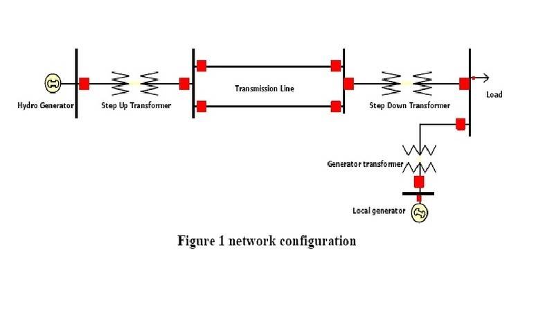

The objectives of this exercise is to develop a load flow algorithm based on Gauss Seidel method and then investigate the phenomena of transport of active and reactive power over transmission networks.
Background
A remote load centre is supplied by a remote hydro generating station over a 210 km long transmission circuits that operates at 275kV and local fossil fuel generator, as shown below in Figure 1.
The analysis required will be performed using a Gauss Seidel Power Flow that you are required develop in Matlab. Convergence criteria should be 0.1% power mismatch.
