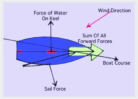

If you want to understand how a boat can sail upwind, stop looking at the sails: look under the water.

I am first considering a saiboat sailing upwind at an angle. The wind pushes on the sail producing a force ##F_{wind}## that is perpendicular to the sail surface (we assume the sail is smooth enough that there is not force of friction parallel to the surface). The force #F_{wind}# can be decomposed into two components, one parallel to the boat direction of motion and one perpendicular to it. The perpendicular force is balanced by the resistive force jointly produces by the keel+hull. All that is left is the propulsive for pushing the boat forward.

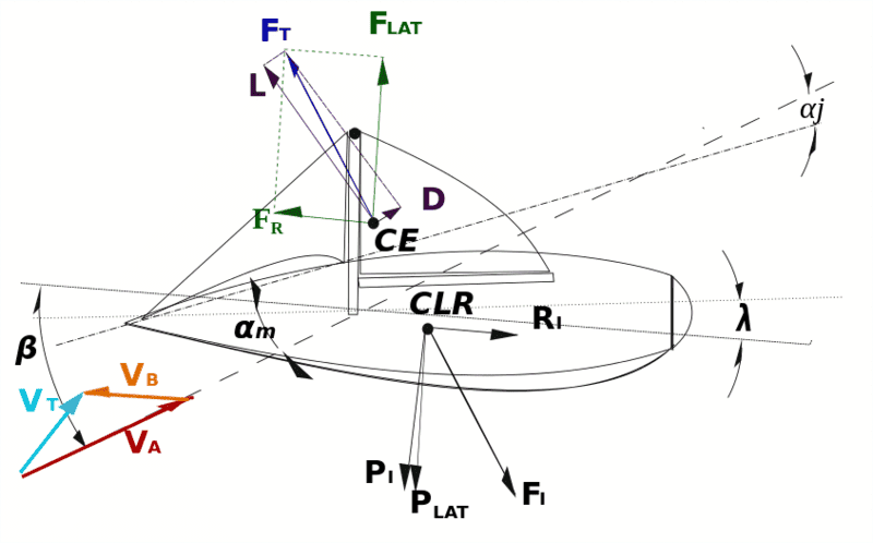

This article may help. Despite the title, it talks about both forces on the sails and forces on the hull. As you will see, even a simplified treatment takes much more space than we typically put in a forum post. The effort to really understand it is roughly equivalent to a college engineering course.
https://en.wikipedia.org/wiki/Forces_on_sails
This diagram may also help.
Likes fog37, berkeman, hutchphd and 1 other person

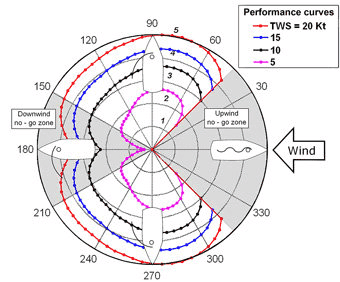

No, high performance craft achieve their maximum speed at 120-150° from the true wind. I haven't got a calculator in front of me but at 5x wind speed I think this is less than 10° from apparent wind.

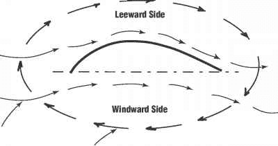

What does the ellipse of clockwise arrows represent?
I don't know. I got that image from Google images searching for sail streamlines. I also wondered about the ellipse, but it was the best image I found.
If memory serves, there's vorticity associated with airflow over a wing. I guess that's a sketch of the sense of it, though not magnitude or distribution.

Yes, the airflow can be decomposed into different flow solutions (like superposition), one of which circulates around the sail as shown.
