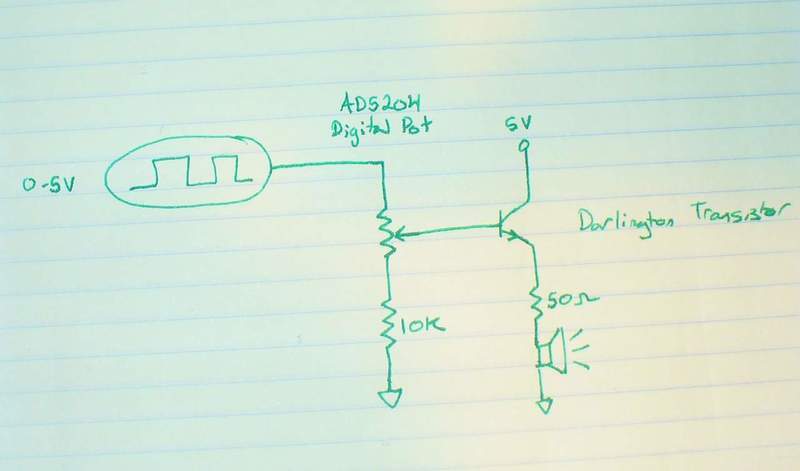

Hey all!
I'm trying to drive 5 speakers, each at a different preset frequency. I had been using the timer in my microcontroller to drive one, but it would get very messy to drive 5 simultaneously in software using just the 1 available timer. I've decided to drive each with a Hardware-generated squarewave instead.

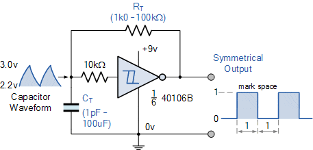

I figured the easiest way to do this would be to simply use a circuit like this one:
I'm using an ST M74HC14 Hex Schmitt Inverter for the job. This should theoretically generate a really nice 50% duty cycle square wave. Unfortunately, my speaker seems to disagree. When I drive it via my microcontroller timer I get a nice clean tone, but with this wave, the tone is uneven sounding and a bit choppy.
So, I looked at the two square waves on an oscilloscope. They both looked almost identical except for one thing. The timer-generated wave was precisely 50% duty cycle, whereas the trigger-generated wave was about 52% duty cycle.
Looking more closely at the datasheet for my Schmitt Inverter, I noticed that the output switch wasn't perfectly symmetrical, which is probably the cause the slight duty cycle issue. Here is the datasheet: http://www.st.com/stonline/books/pdf/docs/1901.pdf

I'm not driving the speaker directly. The square wave goes through a variable resistor (to control volume) which then goes to the base of a darlington transistor. 5V flows through the darlington, through a 50ohm resistor, then through the speaker to ground.

Here is the circuit I'm using right now.

That circuit would work for square waves although strictly you should not pass DC current through a speaker.

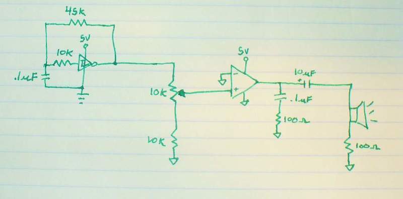

I happened to have an LM386 laying around, so I set up the circuit in the attached schematic.
When I use the schmitt trigger squarewave generator (as in the schematic) the speaker just hums a bit at a low volume. It doesn't not change volume at all as I adjust the potentiometer.
If I drive it from the microprocessor's timer squarewave output (the method that I will NOT be using in the final design), I get a pretty nice loud tone, though it still does not change volume as the potentiometer is adjusted.

The 386 amplifier has a 100 ohm resistor in series with the speaker. This would be dropping the output to about 7% of its full capability.
Also, you could take the output of the Schmitt circuit via a 100 K resistor and a 0.1 uF capacitor in series. You would be grossly overdriving the 386 at present.
Omit the 10 K resistor in series with the pot. Put the pot in so that it is grounded at one end. Take the output from the moving contact of the pot directly to the 386.
You can get a better sound from the Schmitt circuit if you take it from the 0.1uF capacitor where it joins the 45 K resistor. This should be approximately a triangular wave. You should be able to observe this waveform with your oscilloscope and see if it gets distorted in the amplifier.
Also, the 10 uF capacitor at the output of the 386 is too small. I would suggest about 470 uF or bigger.
