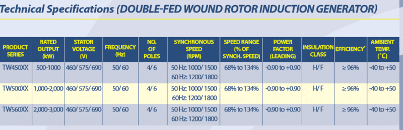

Has anybody mentioned "Double fed wound rotor" ?
http://www.tecowestinghouse.com/PDF/DF_WR_Induction_Generator_Flyer.pdf

jim, isn't the double fed wound rotor generator just a fancy way of calling an induction generator that has windings on it's rotor which being brushless gets its current from an ac field coil which then is rectified in the rotor to supply DC for whatever the pole count on that rotor ?
Close. That'd be a synchronous machine.
It's simply a wound rotor machine. They can be brushed or brushless.
If you short circuit the rotor windings it's an induction machine.
If you apply DC to the rotor windings it's a synchronous machine.
If you apply AC to the rotor windings , "double fed", well, now its field flux doesn't rotate at same rate as rotor is turning.. So you can shift the speed-torque curve off synchronous speed. That's handy for windmills.
