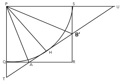

Suppose that $PQRS$ is a square with side $p$. Let $A$ and $B$ be points on side $QR$ and $RS$ respectively, such that $\angle APB=45^{\circ}$. Let $T$ and $U$ be the intersections of $AB$ with $PQ$ and $PS$ respectively. Prove that $PT+PU\ge 2\sqrt{2}p$.

The circle centered at $P$ with radius $p$ has a tangent at $Q$, $S$. Let $AB'$ be the tangent at $H$ to the above circle. Then $PA$ is the bisector of $\angle QPH=\alpha$, $PB'$ is the bisector of $\angle HPS=\angle \beta$, and hence we have $\angle APB'=45^{\circ}$ because $\alpha+\beta=90^{\circ}$.
From this, we conclude that $B'=B$.
Thus,
$\begin{align*}PT+PU&=\dfrac{PH}{\cos \alpha}+\dfrac{PH}{\cos \beta}\\&=p\left(\dfrac{1}{\cos \alpha}+\dfrac{1}{\cos \beta}\right)\\& \ge p\left(\dfrac{2}{\sqrt{\cos \alpha \cos \beta}}\right)\\& \ge p\left(\dfrac{2}{\sqrt{\cos \alpha \cos (90^{\circ}-\alpha)}}\right)\\& \ge p\left(\dfrac{2}{\sqrt{\cos \alpha \sin \alpha}}\right)\\& \ge p\left(\dfrac{2\sqrt{2}}{\sqrt{\sin 2\alpha}}\right)\\& \ge 2\sqrt{2}p\end{align*}$
Equality holds when $\alpha=\beta$, i.e. $\angle QPA=45^{\circ}$
