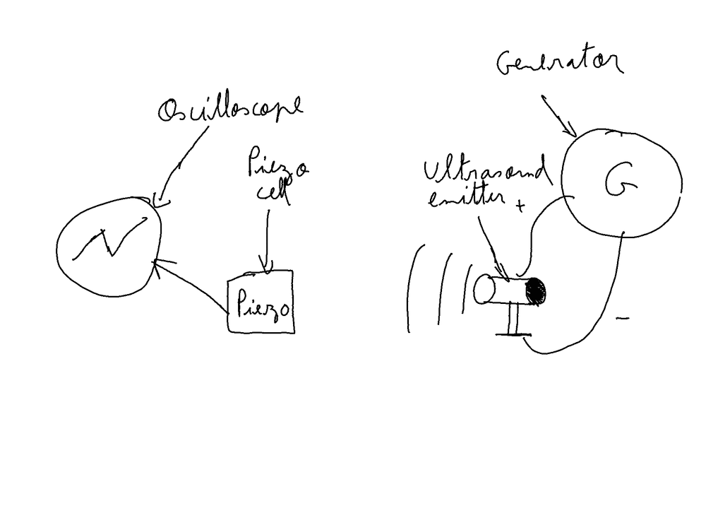

I'm working on ultrasound probes, and I wanted to measure the electrical signal generated by a piezoelectric device (a transducer).
Here is a sketch of the experiment :
The goal of the experiment is to compare the electrical signal of the piezoelectric cell and compare it with a mathematical model.

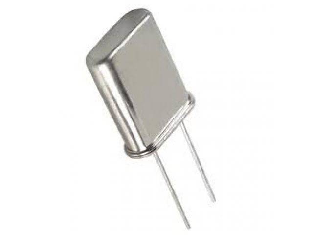

However, my school can only give me this type of piezoelectric device that you can find in a watch :
I don't think this kind of device will be sensitive to the ultrasounds. So here is my first question, at the place of the square with "Piezo" written in it, what electrical component should I put?
Does this kind of device work ? Here
I also wonder if I should amplify the signal of the piezo... If I have to I don't know how...

I think I'll plug the ultrasound emitter on the oscilloscope also but I'm not particularly interested in measuring the ultrasonic sound wave. I'd like to use ultrasound wave with a frequency from 1 to 15 MHz ( these frequencies are used in ultrasound). About the accuracy I don't know what to answer. I think the piezo cell will generate a voltage of some mV (I think) so having an accuracy of tens of mV should be fine.

In a first approach there is no probe, just a system acting like transducer that you can find in probes, to analyze the electrical signal received. I'll work in the air in a first time and then in water. But my question is which component should I use to simulate the behaviour of the piezo transducer.
