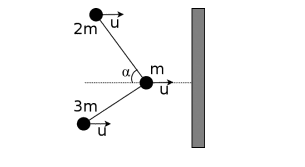

Three masses m, 2m and 3m are connected by two massless and rigid rods
of length l which are currently perpendicular to each other, as shown in the
figure. If the masses initially travel at velocity u towards a vertical wall and
mass m undergoes a collision with the wall, determine the impulse delivered
by the wall to mass m if the final horizontal velocity of mass m is zero. There
is no friction between the wall and mass m. Assume that the tensions in the
rods are strictly longitudinal (because they are massless).
