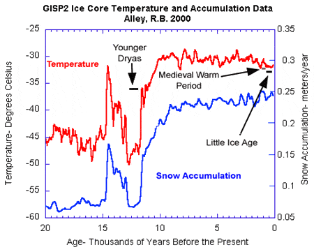

  • #104
vanesch said:
We have had, according to their saying, official members of the IPCC here on this board requesting that discussions be closed simply because they were putting in doubt aspects of the AGW hypothesis, and that this should be treated as crackpot stuff, as if it were creationism or something of the kind.
I should not react to the less apparent due diligence of that IPCC groupthink but this is insane. If you can't win the discussion, remove the opponent. Why wasn't this alleged IPCC member invited to refute the rebuttals and demonstrate the robustness of the climate change notion?
Problem is that all evidence has evaporated; the ice cores; the hockeystick and the actual records.
In the beginning there were the ice cores showing a remarkable correlation between "temperature" and carbon dioxide. Given the greenhouse effect hypothesis this appeared to be a rather convincing substantiation, which certainly warranted climate caution.
But later research showed a substantial lag of CO2, following temperatures and the alternate guess of explaining it away as positive feedback, has never been substantiated. Instead, the characteristic behavior of positive feedback is missing. It actually shows that CO2 did nothing observable, essentially falsifying the estimated greenhouse effect of CO2.
Then came the hockey stick, Mann et al ironing out the wrinkles of the Medieval Warming Period and the Little Ice age in the last millennium; showing an overwhelming convincing nobrainer correlation between temperatures and CO2 both rising dramatically in the last millenium.
But then it was demonstrated that the hockey stick was mainly based on an incorrect algoritm, causing all Monte Carlo simulations to produce hockeysticks. Later reconstructions of the last millennium do show the Medieval Warm Period and the Little Ice Age again, demonstrating the predominance of natural variability independent of CO2. Mind that he discussion, whether or not the Medieval Warm Period was warmer than today, is irrelevant and plays no role in asserting the “warming power” of CO2.
An then the actual records; indeed the temperatures and CO2 were rising simultaneously in the last quarter of the last century, again suggesting causality. However the warming trend diminished around the beginning of this century, while the CO2 continued to rise, again demonstrating that natural variability outperforms CO2.
Notice also that melting glaciers, a warmer Arctic and rising sea levels, merely proof changing conditions, but not what caused those changes. Furthermore, notice also that climate model runs, based on the unproven hypothesis merely constitute circular reasoning. That’s no evidence either.
So what is the evidence left that supports substantial warming due to rising levels of CO2? I can’t think of any. Instead we have competing hypotheses (Chilingar et al 2008, Miscolczi 2007) explaining why the basic idea’s of the greenhouse hypothesis may be incorrect.
But it doesn’t matter since we have to curb emissions anyway to transit to sustainable energy, right? Wrong. It matters because science is turned into ideology or dogma here to enforce policy. That will backfire hard eventually when proven incorrect in the future. Perhaps we should let the governments be run by engineers, who can’t afford basing their designs on unproven dogmas.
