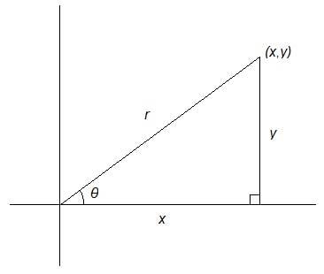

The first is obtained directly from the definitions of the sine and cosine functions, while the second is a result of the Pythagorean theorem. Consider the following sketch:
We have the point $(x,y)$ to which we draw a line segment from the origin, and lalbe its length as $r$. From the point we drop a vertical line segment to the $x$-axis (at the point $(x,0)$ and its length must be $y$.
Using the definition of the sine function on this right triangle, we find:
$$\sin(\theta)=\frac{\text{opposite}}{\text{hypotenuse}}=\frac{y}{r}$$
and so we find:
(1) $$y=r\sin(\theta)$$
Likewise, using the definition of the cosine function on this right triangle, we find:
$$\sin(\theta)=\frac{\text{adjacent}}{\text{hypotenuse}}=\frac{x}{r}$$
and so we find:
(2) $$x=r\cos(\theta)$$
We may also observe that:
$$\frac{y}{x}=\frac{r\sin(\theta)}{r\cos(\theta)}= \tan(\theta)$$
Hence:
(3) $$\theta=\tan^{-1}\left(\frac{y}{x} \right)$$
Note: If $x=0$, then $$\theta=\pm\frac{\pi}{2}$$.
By Pythagoras, we can then easily see:
(4) $$x^2+y^2=r^2$$
So, having these relationships, we can now answer the questions.
