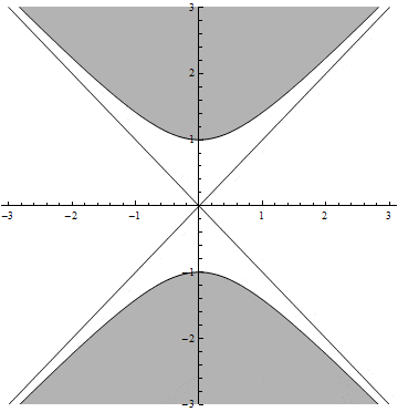

I can't speak for PAllen, but I don't. Some statements regarding Rindler horizons are coordinate-independent, invariant statements. Here's one: "No light signal can travel from any event in the region 'inside' the Rindler horizon, to any event in the region 'outside' the Rindler horizon."
Of course, which null surface counts as the "Rindler horizon" depends on where you put the "origin" of the light cone that defines it--or, equivalently, which particular set of accelerating Rindler observers you pick to define the horizon. The event horizon of a black hole differs from the Rindler horizon in that respect, because Schwarzschild spacetime has only one timelike Killing vector field, but Minkowski spacetime has an infinite number of them--in fact, two infinite families of them (one family for all possible inertial frames, and one family for all possible Rindler frames). So Minkowski spacetime has an infinite number of possible Rindler horizons, but Schwarzschild spacetime has only one event horizon.
However, you can still make a similar statement to the one I made above, about the event horizon of a black hole. The fact that the exact location of the horizon (i.e., exactly *which* null surface it is that defines the boundary between the two regions) can't be known without knowing the entire future of the spacetime, doesn't make the statement any less invariant.

I will respond more later, but a way I would phrase it is that a horizon is observer dependent, but this attribute off a particular observer or class of observers is not coordinate dependent.
To make this explicit for the Rindler horizon, note that there is no need to use Rindler coordinates. It is, in fact, easier to derive the Rindler horizon in Minkowski coordinates, though I have seen few authors approach it this way: draw the world line of an accelerating observer; compute the envelope of all its backward light cones; this envelope remains completely below the 45° asymptote of the world line. Thus, the spacetime above this asymptote is causally disconnected from the accelerating observer.
Similarly, for the class of BH external observers, spacetime inside the horizon is causally disconnected from these observers. However, a free fall observer's past light cones include events on both sides of the horizon (as well as events from possible world lines of earlier infallers) right up until the singularity. Thus, the feature of the horizon being a causal boundary is, as with Rindler, observer dependent but not coordinate dependent (everything above is phrased in terms of observer light cones, not coordinates).

The horizon is a surface - a geometric object - and is thus invariant. However, it represents a causal boundary only for some observers (a very large class - those that remain forever outside). Radial infallers do not perceive it as a causal boundary.
Note again, an analogy with the Rindler horizon is possible. Define such a horizon by a particular observer's accelerating world line. Then no observer has events 'beyond the horizon' in its causal past until such observer has 'crossed' the horizon.
Yes, I agree. But in the case of the Rindler horizon, you have to add that qualification "define such a horizon by a particular observer's accelerating worldline", which defines which timelike Killing vector field's horizon you are talking about. In Schwarzschild spacetime, no such qualification is necessary.

In the Rindler case the horizon is just the boundary of the Rindler cordinates, and given the fact that light has finite speed it is only natural that observers at constant position in that universe that must have constant proper acceleration perceive a horizon at a certain distance where they can no longer receive light, but that is not a property of the physical location of the horizon they perceive, it is a property of light motion and their own motion (constant proper acceleration).
Of course the Rindler coordinates are a chart of an idealized spacetime, the Minkowski one, that is not ours. Rindler observers are in a certain frame and can't change their state of motion as long as they want to keep being Rindler observers.
So in this limited sense sure the horizon is "real" for the external observer, meaning it is perceived as such by him, but that has nothing to do with the horizon in itself, it is not something physical.
