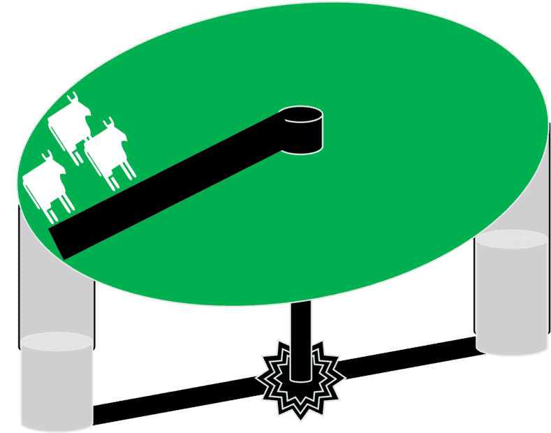

Thanks for your input, regarding the weight being lifted back up, let's say we're to use animals to take the loads back up to the top.

You will need more knowledge of power, energy, and simple machines (gears, pulleys, levers, etc.) to understand our answers. PF isn't a great place to learn basic physics. It is a great place to ask questions about the parts that confuse you though.
A gear ratio of 1:100 can reduce the rotational speed by 100x, but it will increase the torque required by 100x also. The power is unchanged. This is why I could calculate the speed of your mass without knowing anything about the system down stream. You must make the power required from your mass falling first, then you could modify speed/torque as needed.
Khan academy has some good physics tutorials.
The wiki might be enough. It's a pretty simple/straightforward concept:
https://en.m.wikipedia.org/wiki/Mechanical_advantage
The key is simply recognizing that conservation of energy always applies, so you can't just assume if you spin at nameplate rpm you'll generate nameplate power.

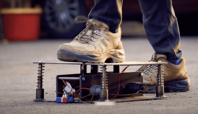

I think the below picture will give a clear understanding of my question, stepping on this device below generates a little electricity. My question is that, since a human weighing on average 80kg, stepping on this device will generate small watt of electricty, what if we have a heavy object of 500kg stepping this device and connected to a bigger motor. Let's work with 30kw, 500kg weight, height depends on the setup. I hope i convey the question clearly now.
Nope. Sorry, weight isn't the same thing as power. More weight doesn't necessarily mean more power.
You need to study high school physics.
Likes sophiecentaur
kingamada said:
Yes, something like this, my major concern is knowing the power that i can generate from 500kg weight, would using a high capacity motor yield more energy? If so which motor(if i connect it to small 50watt motor or 30kw motor to a 500kg wight, would energy that would be generated be the same?) and setup would i need to effectively use 500kg of weight. In the case of Ares North America, they use a car cable method.
You're still approaching the problem backwards. You need to figure out or specify how much mechanical energy/power you have available, and then you simply match the generator to it. @DaveE gave you most of the answer and how to figure that out in Post #5.
For the generator selection; there is no benefit to over- or under-sizing the generator: too much and you waste money and lose a bit of efficiency. Too little and you'll either generate less power or damage the generator. If you have/want 50W you use a 50W generator. If you have/want 30kW you use a 30kW generator. That's it.
Likes sophiecentaur

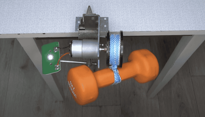

OP if you are interested, there is an existing technology common in industrial cranes where when the load is lowered down, the rotational force it produces to the motor is converted back to electricity so that it will help in braking the lowering of a load to a stop. Its called regenerative braking, however, this is really not a feasible idea for any scale of power generation that you want to achieve.

This is a dreaded Energy Harvesting Scheme. You must realise that the only systems that harvest successfully are where you have a shed load of energy that you feel you have to get rid of. Significant Energy from people walking will wear those walkers out very quick. They will avoid that particular route on their walk.
