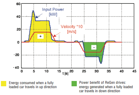

Ibix said:
To get 10kW of power out of a 500kg mass you need it to be doing 20m/s. In free fall from rest that takes 2s and 20m of vertical distance. He's only got 5m. The maximum possible speed he can achieve with a 5m drop is 10m/s, so the hard upper limit on power out of this device is 5kW. And that's a peak output only achievable for an instant if he wastes a full charge to spin it up.
You are describing a scenario where all of the energy extraction occurs at constant speed, with the braking force equal to the weight of the object lowered. As you indicate that will waste the kinetic energy of the acceleration phase (not to mention what happens when it hits the ground...). That's not the only way to do it. Consider the real life example of an elevator with energy recovery and electromagnetic braking. It has three phases of energy extraction:
Acceleration phase. During acceleration the braking force will be lower than the weight of the object being lowered, but won't be zero(for an elevator) and there is some energy extraction. For the OP's device it could be zero if desired.
Coast phase. In this phase you will have the constant speed energy extraction as you describe.
Deceleration Phase. During this phase the braking force is larger than the weight of the object being lowered. For an elevator the deceleration rate will be constant (with rounded inflection points) therefore the power profile will start with a higher power than the coast phase and then drop towards zero as the elevator comes to a stop. This profile is of course an arbitrary choice and if we wanted to achieve constant power deceleration at any selected power output, we could.
Here's a graph of the speed and power of an elevator, and a link to their brochure:
https://www.otis.com/documents/2560...1-af7d-b4b3-ecc1-547c2984fbf1?t=1591127484167
Note: The device OP envisions is, in fact, an elevator.

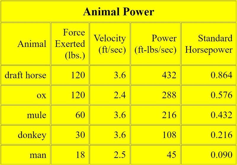

I have to emphasize again that the first step is always identifying how much energy/power is available. The problem with this ask is that you havent defined the scenario because you don't know what the animals can or are willing to do. That's not an engineering question so I'm not sure how much we can help.
I will say this though: we Yanks use horsepower as a unit of power for a reason: hundreds of years ago people put a lot of thought into how much power British animals can generate if properly motivated. There might be some modern or historical research on that.
Fortunately, somebody has done this:

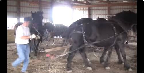

That is the power that these animals will deliver over a normal work day under ideal conditions. Ideal conditions for most draft animals would be walking in a straight line on level ground that is soft enough to get traction and hard enough to not waste energy.
Stepping on power levers would be like walking on very soft sand. The power would be generated by pushing down against resistance with muscles evolved for pulling forward. The result would fatigue the animal while generating minimal power.
Animal power works best by pulling in a straight line, as in farm field work. Animals can also walk in circles while connected to a capstan. The image below shows a ten horse capstan drive:
And then there are the conversion losses. Converting pulling power into lifting a weight will have friction losses. The potential energy added to the weight will be less than the power delivered by the animal. There will be further friction losses as the weight drops. The generator has inertia, so takes more energy to spin it up. A 10 kW generator might be 80% efficient, so 20% of the power turning the generator shaft will be lost as heat. There are standby losses because animals keep eating on their days off. With additional power losses to remove and dispose of manure. And don't forget that controlling the that animal is a full time job for a human.
When all of the losses are added up, the useful power delivered to a load will be less than 10% of the power delivered by the animal. Animal power can be effective when used directly, as in pulling farm equipment. But not when used to lift a weight to generate electricity to drive that load. In that case, the human could drive the load directly using pedal power, and eliminate the horse.
Likes sophiecentaur, russ_watters and Bystander
