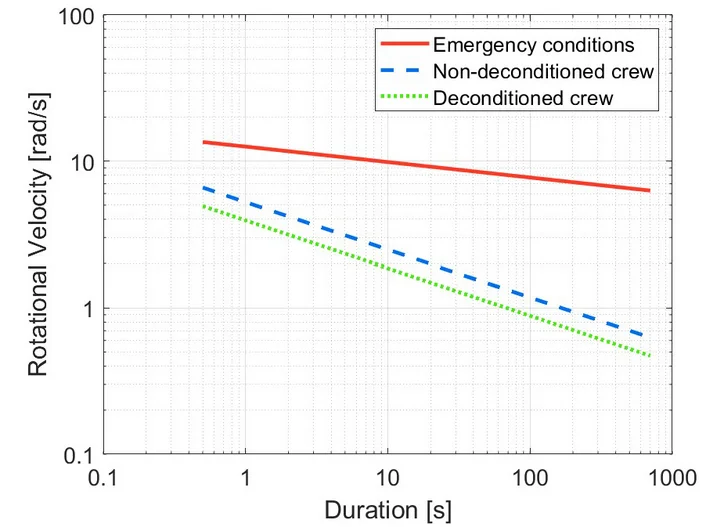

You can perhaps take a peek at a recent study to get a feeling for the numbers involved: https://www.nature.com/articles/s41526-020-00112-w
Edit: for overview of many issues you may also want to peek at NASA STD-3001, where section 6.5.2 of volume 2 shows the "current" limits as
Likes russ_watters, PeroK and wrobel

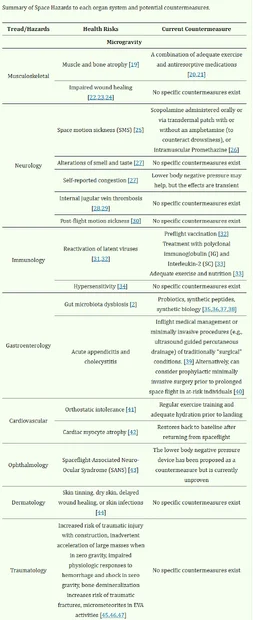

There is a large body of research on the negative health impact of prolonged exposure to microgravity - including bone loss, muscle loss, vision problems, inability to heal wounds - the list is large enough to put doubt on the viability of long-term human settlement on Mars or the Moon
https://pmc.ncbi.nlm.nih.gov/articles/PMC9818606/
Indeed, that is why I specifically said effects of microgravity relative to the effects when in total weighlessness, that is, the known and suspected effects of being in a microgravity enviroment are due to lack of large acceleration. When talking astronauts health, the term microgravity is generally thought to include effect of zero weight (that is astronauts will suffer the consquences no matter if they are in a zero-g or micro-g environment), whereas microgravity in experiments and similar contexts often is meant to exclude zero weight. For instance in crystal growth experiments and similar where as-close-to-zero acceleration is desired, microgravity is usually taken to mean the presence of gravity gradients and vibration modes occuring from the experiment being attached to a large (station) structure instead of being free floating.

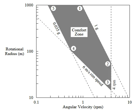

The vestibular effects look quite serious and a persistent mismatch between what eyes see and what the inner ears sense can be nauseating and disorienting. (I recall [don't have a link offhand] a study using a room rotating around a vertical axis - the inner ear senses rotation in that direction the same as it senses head over feet tumbling - and even experienced pilots suffered. If I recall correctly people didn't acclimatize, the effects got harder to put up with over time).
It sounds a lot like the too much alcohol effect, only it won't go away. That seems more problematic than bodily sensations and changing forces from coriolis and compensating for them.
I would expect acclimatizing isn't going to work when simply turning your head changes what the inner ears sense; the sensations don't stay constant enough to get used to unless you stay still.
Large diameters and rotation rates below the threshold for vestibular sensations seem advisable.
Indeed.
Earlier in this thread I couldn't find the old (1999) overview paper [1] I usually refer to on this, but finally managed to dig it out. It has this nice diagram based on various limits:
[1] https://www.artificial-gravity.com/JBIS-52-7-Hall.pdf
