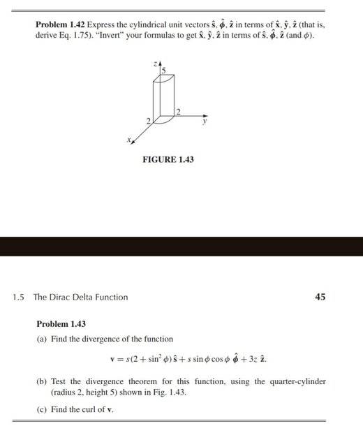

TL;DR Summary: Confusion in φ cap direction for Left & Back face
The image of the question is shared at this Imgur link - The only issue I'm facing in this particular problem is in calculating the flux through the "Left" & "Back" faces of this quarter cylinder.
More specifically the issue is in the direction of φ cap, because I'm unable to understand or figure out how or why we considered it to be negative for Left face & positive for the Back face. This is something I'm unable to visualise. Further adding fuel to the fire is the knowledge that unlike Cartesian system, these coordinates don't have a "fixed" spatial direction as such. So how can & how are we assigning positive-negative directions here?
Additionally, it still didn't make sense for the negative angle direction except when I consider this- φ is the angle made wrt the x axis. For the left face, the direction is negative because the angle makes a clockwise movement. In case of the back face however, the direction is positive because the angle traced while reaching that particular face is anti-clockwise. Does it make sense to you too/is my interpretation correct?
Please guide.
Which problem are you asking about, 1.42 or 1.43? By convention, ##\mathbf{\hat {\phi}}## points in the direction of increasing ##\phi## which is anti-clockwise looking down the ##z-##axis.
When finding the flux ##\oint \mathbf v \cdot \mathbf{da}## of a vector field ##\mathbf v## through a closed surface, the area vectors ##\mathbf{da}## point outward from the enclosed region. So, you need to consider the relation between ##\mathbf{da}## and ##\hat{\boldsymbol{\phi}}## for the left and back sides of the quarter-cylinder.
Likes physics_student01
Care must be taken calculating flux from a closed surface. The efflux (from inside to outside) is defined as positive (this also coincides with the definition of the unit surface normal vector). So you need to be cognizant and adjust the calculation appropriately.

Thank you for responding! My issue is with 1.42, one of its parts where Flux needs to be calculated.
I believe as per your insight, my interpretation mentioned in #1 seems correct. Do you also think so?
Yes indeed. But for the Left & Back side, somehow it is not clear why one is positive & the other negative. I was suspecting it has to do with clockwise/anticlockwise sweep of the angle as mentioned in #1. Is that a correct way of thinking about it?

The issue is the sign of ##\vec v \cdot d\vec a## as explained above

The finite length quarter cylindar has 5 surfaces: four of them are flat. Have you forgotten the surfaces in the x-z plane and in the y-z plane???? What about them?
