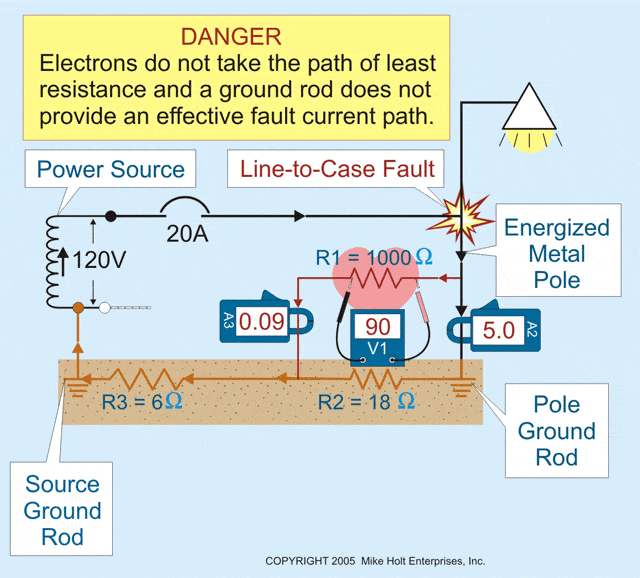

tnis photo courtesy http://inspectapedia.com/electric/Electrical_SEC_Sizes_Amps.php
Observe in this picture that fault current from "Load" can make it back to Utility Power centertap X0 without using earth.That point is tied to Earth at the meter, which is usually right at the entrance to that panel.
We used to use the incoming water pipe but with the popularity of PVC pipe we now drive a grounding electrode, usually a copper coated steel rod, at the service entrance.
The reason for that is to keep high voltages, arising from either lightning or a primary to secondary short in utility transformer, out of the house
Without the bonding conductor , 'Ground" would become a voltage divider and might not even trip the circuit breaker
It's important to have awareness of the distinction between "Grounding" and "Bonding".
Bonding ties equipment together.
Grounding ties equipment to earth.
Unfortunately we use those two different terms as if they were interchangeable.
That''s a language problem not an electrical one.
