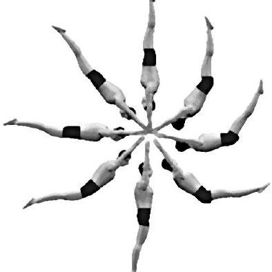

Where is the maximum torque when a gymnast is doing a giant (circle around the bar)?
The giant goes counter clockwise. In my opinion the maximum torque is at 3/4 of the circle. How to further explain the answer?
The-backward-giant-circle-on-the-high-bar-The-gymnast-circles-from-the-handstand_Q640.jpg

Are you familiar with the vector equation for torque? If not, what is the equation that you use to calculate torque, and what defines the angle in that equation? :smile:

You are assuming a friction-free grip on the bar and a rigid man?
And you want the position where the force of the bar on the man's hand exerts the most torque about the man's center of mass?
It seems to me that there is a straightforward way to determine the torque supplied by the bar on the man's hands about the man's center of mass. But first one needs to know the man's angular acceleration.
There is a straightforward way to know the man's angular acceleration: Can you figure out the net torque on the man about the bar?
Of course, I haven't given enough detail. My question would be the biggest torque on the athlete. Do I make sense?

The gymnast in the accompanying diagram does not seem to be assumed rigid. It seems like they want us to consider how the CoM is changing in each position. I wonder if this is supposed to be qualitative exploration?

That is a sensible interpretation. Maximum torque from gravity about the bar.

Indeed, it is this torque that provides angular acceleration, allowing the athlete to rotate faster around the bar. In order for this not to cancel out in between both sides, the athlete must change the torque by gravity when going up relative to when going down.

Alternately, the athlete may arrange for the time interval going up to be less than the time interval going down. [The same sort of contortions that assist in the one tend to assist in the other, so it is difficult to separate out the two tactics]

I guess I'm meant to observe the athlete as a lever. I'm not sure how to give a better explanation since English is not my first language. Isn't it the biggest torque at about 90° angle if we consider gravity in the first half of the motion, kind of similar as when doing a biceps curl?
I think you are to qualitatively compare the CoM of the gymnast (think about how his CoM is changing as he is extending and contracting), as well as the component of his weight perpendicular to the line joining his CoM to the axis of rotation for each position shown. If you think about it like this, the answer will become apparent.
