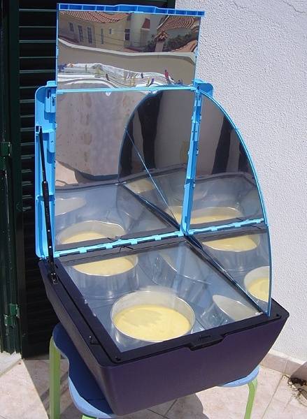

A solar oven (at night) would work. This issue is why cars (not to mention telescopes) get dew/frost on them so easily.
Ah. I should have known from all the time I spent unfogging my telescope mirrors with a hairdryer.
Could you explain how?
Take the solar oven, but make it large and flat. The four sides would be insulated, the glass would be double-paned, also for insulation (but of a type that transmits IR well). The back of the chamber would be made of aluminum, painted flat black for maximum emissivity (would need to confirm the paint's IR emissivity). Evacuate most of the air out of the chamber to limit the convection loss.
Heat will flow from the ambient air, through the aluminum panel, where it would be radiated into space. Like a water-wheel interrupting a stream, a heat engine interrupts a flow of heat energy and harnesses it. So you connect the back panel of the thermal radiator to a Sterling engine, since Sterling engines are capable of functioning with a low delta-T.
