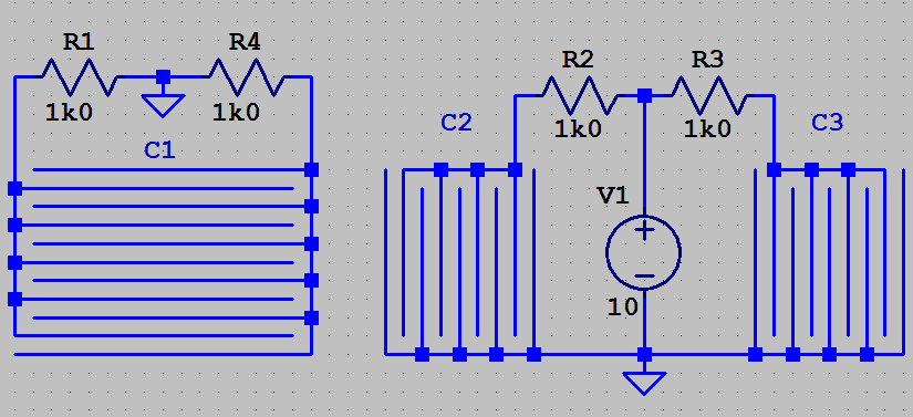

Draw an electrical circuit that can then be analysed.
Here are a couple of possible circuits.
In the first circuit the C1 capacitance is loaded by R and will discharge. Without an excitation voltage there can be no charge to pump, V, Q and I, will settle to and remain at zero, even with changing capacitance.
In the second circuit C2 and C3 alternate in capacitance. Excitation is provided by V1. As capacitance changes current flows back and forth through the R loads.
In the OP you show two capacitors, because they are separated by the wavelength, they are always immersed to the same depth. Change the separation to half a wavelength and they will alternate in capacitance and charge. Then circuit 2 may be applicable.

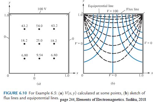

Because the electrostatic field will not penetrate between the two connected plates. Penetration of the electric field is necessary to get high plate area, so it needs a metal conductive plate, probably made from chicken wire so the water can flow in and out.

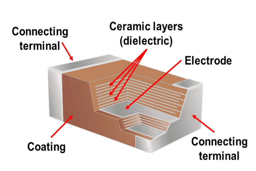

All capacitors are made with some kind of stacked electrodes, connected to a bus bar. All I suggest is that we replace electrodes on one side of the capacitor with sea water that is subjected to waves and sometimes enters the capacitor and sometimes leaves it.
The other side is still the same set of plates, connected to a bus bar, all coated in a dielectric.

What difference would it make if capacitor plates on one side were made of metal or salty water?
Metal guides the electric field, salt water does not, so the field takes a short cut.

tarakan said:
How does the field not take a shortcut in regular capacitors?
Because they are inter-fingered, so the opposed metal plates are very close to each other and parallel. There are no deep slots that do not contain the opposite metal plate. The electric field will not effectively penetrate more than about the width of the slot between the equipotential connected sides. The slot volume of the capacitor therefore does not contribute to the capacitance, so it will all be dead space, a wasted plate. The analytic solution to the field in a deep and narrow slot or trough is available as a student exercise, there is a general example here;
tarakan said:
I asked you how much power can such capacitor device produce from each change of "wet" to "dry" or full to empty.
The power output will be proportional to a number of parameters.
1. Wave frequency. You do not control that. Estimate it based on a 10 second cycle, = 0.1 Hz.
2. Capacitance. There is a fundamental problem with the design of the 'prong' like capacitor where the seawater is both the dielectric and one of the capacitor plates. It does not work the way you hope. The capacitance will be minimal as you have it designed. You will need to design a capacitor with two inter-layered mesh plates that can be dunked in seawater.
3. Voltage. Seawater is incompatible with high voltages. The dielectric constant of insulation ≈4, is lower than sea water ≈80. Thicker insulation reduces the capacitance faster than it increases the operating voltage. You need to evaluate the different forms of painted or powder coated mesh.
4. Viscosity of water. To get high capacitance the capacitor volume must be filled with closely separated mesh electrodes with a huge surface area. Water will not flow easily through such a structure. The forces applied by storm waves to the capacitor will be destructive.
5. Biology. The cyclic flow of water every ten seconds, into and out of the capacitor, will seed algae on all surfaces. That necessitates lifting the capacitor each day, draining the sea water, then dunking it in a tank of bleach. If you miss a day you will need to dismantle the mesh “filter capacitor” and clean the plates with a pressure washer. Obviously large plate areas become more expensive to clean.
In the real world, the best you will be able to do will be about;
C = 1mF; dV = 50 volts; period = 10 sec; E = ½·C·V²;
Energy per second = 0.5 * 0.001 * 50*50 / 10 = 0.125 joules per second = 0.125 watt.
If it was possible to increase that capacitance by a factor of 1000, to 1 farad, then the power available would be 125 watt. A solar panel would be a better investment.
Without optimisation, your 'prong' like design might have at best 1 uF of capacitance, so power = 125 μW.
If you don't like those numbers then you need to investigate the insulation available, and understand the electrostatic structure of the capacitor, before you can evaluate the voltage and capacitance. Only then will you be able to calculate the actual power available. I expect it will be less than a watt.

tarakan said:
The circuit is somehow connected with a "ground" to the sea water.
I submerge the plate in a container of sea water.
How do (micro)Farads convert into centimeters squared of an electrode, inside 0.2mm plastic? ...
Capacitance is a parameter determined by the geometry and dimensions of the conductors and dielectric.
It takes two conductive plates to make a significant capacitor.
What area of metal plate is directly opposed to the other metal plate?
What is the separation distance between the metal plates?
The relationship between area and spacing is described here;
https://en.wikipedia.org/wiki/Capacitor#Parallel-plate_capacitor
If you have only one metal plate then the capacitance could be approximated by a spherical capacitor. The inner sphere being the size of the electrode, the outer being the distance to the ground connection.
C = 4⋅π⋅k⋅ε / (1/ri -1/ro)
Describe the geometry and the size of the two electrodes of your capacitor.
