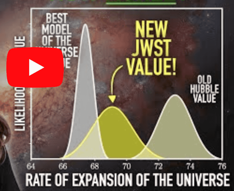

Dr. Becky Smethurst provides a summary of the latest analysis of JWST data by Freedman et al., indicating that there's no statistically significant discrepancy between the value of the Hubble constant thus obtained and the value obtained from Lambda-CDM using Planck data.
Likes Jaime Rudas
Space news on Phys.org
More specifically Dr. Becky said:
Last weekend a conference of the American Physical Society in Sacramento California, a giant in this field, Wendy L. Freedman presented her research group's latest work using data from JWST and now they're claiming a value of the Hubble constant that within error agrees with our best model of the universe. They're claiming now that there is no Hubble tension that the crisis in cosmology has been solved. Of course I had to make a video on this but everything I'm about to say comes with a very big disclaimer: no research papers have been released yet. This work is not peer reviewed. All we have to got on is the 35 minute talk that Wendy Freedman gave at this conference and the slides that go with it.

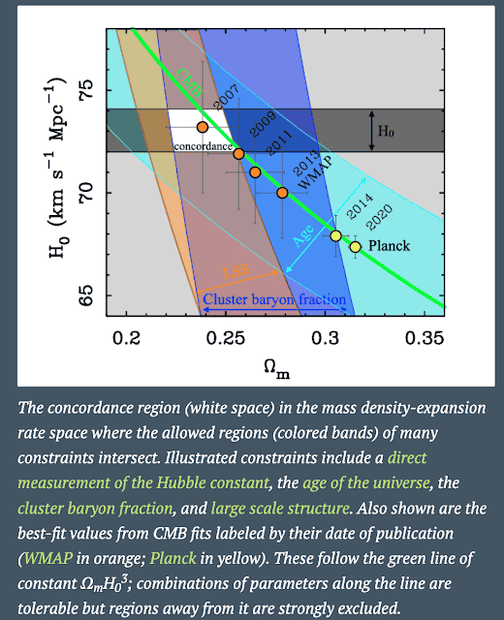

Stacy McGaugh suggests in a blog post that the Hubble tension is probably due to the estimate of Hubble's constant from the cosmic microwave background (CMB) which has gotten lower as greater precision measurements of it have been made, rather than from errors in recent time Hubble constant measurements as it is more common to suppose. He argues that observed early galaxy formation, which is contrary to the LambdaCDM model and thus not accounted for by it when calculating the early time Hubble constant from the CMB, is likely to be a big part of the discrepancy. So, he's basically arguing for a theory error rather than a measurement error (which seems inplausible) in deriving the Hubble constant from the Planck CMB measuements.
This might be the only plausible way that the JWST, which is unique in its ability to do conventional astronomy observations at very high-z, could reconcile the tension. In support of this hypothesis, McGaugh cogently notes that the Hubble tension is largely a result of falling CMB values as that measurement has been refined over time, rather than changing late time Hubble constant measurements, as illustrated in the following diagram:
