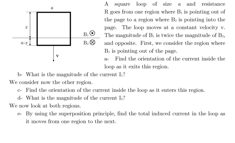

Having difficulty finding the direction of the induced currents
In summary, Lenz's law is best understood through the use of the right-hand rule, specifically the closed fist version. This states that current in the direction of your thumb creates a magnetic field that wraps around as the rest of your fingers. Induction is reciprocal and follows the same principle. In terms of calculations, it is important to consider the sign of the results and what conclusions can be drawn from them. This concept often leads to humorous memories in EE and Physics classes, where students frantically gesture the right-hand rule during exams.
godiswatching_
In the image.
I can find the magnitudes easily. But I am having trouble understanding the directions of $$I_1$$ $$I_2$$ $$I_{res}$$
$$\epsilon = -\frac{d\phi}{dt} = -Bav$$
$$I = \frac{| \epsilon|}{R}$$
I would think about Lenz's law.
If you're more mathematically inclined, as I think is the favoured practise, show your calculations and say what conclusions you reach from the sign of the results.
Right-hand rule is your friend - specifically closed fist version - current in the direction of your thumb creates a magnetic field that wraps as the rest of your fingers. Induction is reciprocal and exactly the same.
I have found and humorous memories of both EE and Physics classes during exams with everyone wildly gesticulating the Right Hand Rule in the air as they tried to orient the answers.
