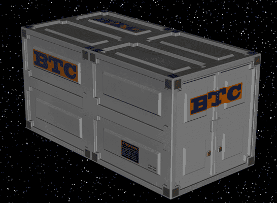

I'm new here.
I am working on a fictional space commerce system using containers to transport things between planets. The container size is 4x4x8 meters and most often it would be colored but call it grey for the purpose of the question. I don't know what you would make it from, I suppose metal as I can't think what else would survive deep space.
My question is this:
The container starts off on an Earthlike planet at std. temp, then is transported into orbit, then loaded on a Space Container ship. How long would it take for the container to drop in temp to near 4K?
I assume that before they got too cold the cargo ship would pass near a star and spin the ship to "rotissierie" the containers to warm them up - but that only makes the questions grow: I am sure that at some low temperature materials such as plastic and lubricant oils will break down - what would be a fair estimate of the safe minimum temp for such things?
Any help greatly appreciated.

First you need to know how much thermal energy it contains. That depends on it's initial temperature and thermal mass. The latter would depend on what's in the container. It might be reasonable to assume it's full of water which has a relatively high thermal mass and that would give an estimate for the longest time. Other materials are likely to cool faster as they have less thermal mass.
If the water starts off as a liquid and ends up frozen you need to include the energy due to the phase change as well so there will be three sums...
1) The energy given out as it's temperature falls from say 298K to 273K. Look up "heat capacity" or "specific heat capacity" of water.
2) The energy given out as it freezes. Look up Latent Heat of fusion for water.
3) See 1) but for ice and the range 273K to 4K.
Add them up. Once you know how much energy needs to be lost then you can figure out how long it will take...
If you treat space as a vacuum then there is no heat loss by conduction or convection, only radaition. To work out the radaited losses you need to know a bit about it's surface finnish.

To get an estimate for the timescale: Fill it with 60m3 of water, take a perfect black body and perfect thermal conductivity. At 300K, this corresponds to 460W/m2 thermal radiation, for a total of ~75kW. Water has a heat capacity of about 4MJ/(m3K), or 240MJ/K. Without external radiation, this gives a cooling rate of 1.6*10-4/s, or 14K per day. The cooling rate quickly drops if the temperature drops - at 150K, radiation dropped to 1/16, so the cooling rate is just 2K/day (taking into account that ice has just 50% of the heat capacity).

I think there should not be a problem keeping contents of the container under some moderate temperature, if proper thermal insulation is ensured. The best thermal insulation at low and moderate temperature is vacuum (it is used in vacuum flask).
Suppose the content temperature is about +20 deg. Celsius. If the container is gold-coated it emitts of approxamately 1 kW of total heat power. It is rather high value. One extra layer of golden foil with vacuum gap between it and the container wall leads to the value of total heat sink of about 30 W. Adding one more layer of golden gold with one more vacuum gap leads to the power of total heat radiation down to less than 1 W. If you place some heat source with such thermal power into the container the temperature of the contents will be constant.
Thankyou AlexLAV, you have been specially helpful. Four layers of gold plate with vacuum in between would be fine - there would be more losses because of the door seams but that must be accepted: I expected that some energy would need to be added to stop things freezing up, this looks more like a good container could make it through a very long trip no problem with only minor energy added.
