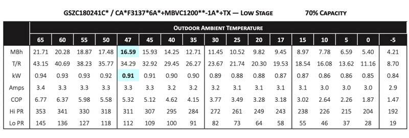

Can you please define the efficiency equations that get you to 600% efficiency for heat pumps? I see sources that say 300% depending on the heat sinks available...
https://brennanheating.com/how-energy-efficient-are-heat-pumps/
Certain sized units in certain classes go up to 600 percent. If you pick a condenser or outdoor unit that has a very large coil for its rated tonnage they will perform in the 600 percent range. But if you chose the same company, the same model but a larger unit with the same square feet of condenser coil it will probably lower to high 300 percent range. You have to shop wisely. I have installed hundreds of systems and after noticing the difference in COP (Coefficient Of Performance) from differently sized units in the same category I started picking wisely.
Every BTU requires 0.293 watts to create. So if a unit puts out 18,870 BTUs and uses 0.93 kilowatts to do that work at 55 degrees, 18,870 times 0.293 watts equals 5,528.91 watts which would be electric resistance heater efficiency. 5,528.91 watts divided by 930 watts of actual usage at 55 degrees outdoor temperature gives you 5.945 COP approximately.
But when you add in the zone dampers you actually get a little higher COP but that is speculative as there are no studies, just my keen observations.
William McCormick
