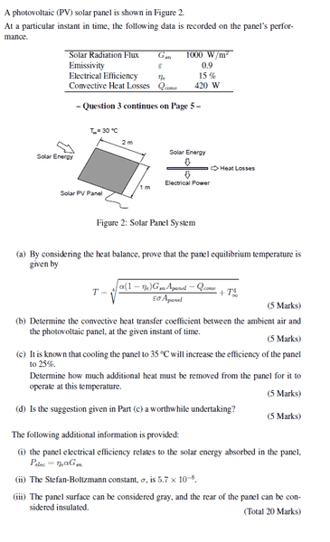

This questions relates to solar radiation and heat balance. I'm having trouble with part (b) of the question, having solved (a) already.
The question is found in the following image:
Qconv=h*A*(T-Tambient)=420 W
Qconv=420 W
A=2m^2
Tambient=303 K
Given T=(The equation found in the link)^(1/4)
Emissivity=0.9
Ne=0.15
Gsn=1000 W/m^2
Aplate=2m^2
Stefan-Boltzman Constant=5.7E-8
The only thing I need is the abosrbance (alpha) of the surface.
I'm really unsure of how to calculate it, given I don't have the temperature of the sun.
Can anyone shed some light?
On a related note, regarding Kirchoffs law of thermal radiation:
Emissivity=Absorbance, given equilibrium temperature.
I'm having some trouble understanding where I can use this relationship. For example, in the given problem, I know that in the instant of time being looked at, the system is in equilibrium. Thus, I can say that the emissivity of the surface is equal to the absorbivity, however, this relationship doesn't apply when I am considering radiation coming in from the sun?

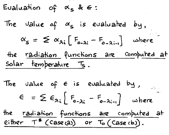

The following is taken from a section of my lecture notes describing the radiation function and the solar absorbance:
i.e. I evalulate the absorbance of the surface at the temperature of the sun, but I evaluate the emissivity at the equilibrium temperature of the surface. I don't understand why this is so -
Sorry fellas, just getting pretty confused here. Any help would be eternally appreciated.
If I remember my thermodynamics properly, for a grey body [itex]\alpha = \epsilon[/itex]. Which applies to any radiating surface I believe.
The convective heat flux (q)=h*A*(Ts-Tinf) where Ts is the surface temp(a above), Tinf is the ambient air temp. h is the convection heat transfer coefficient. A is the area. You know q, A and both T's, looks like plug-and- chug to me.
