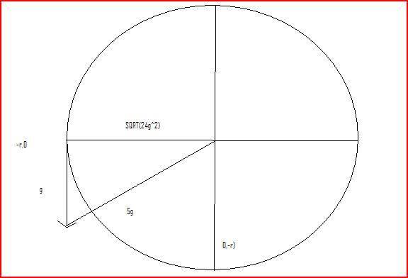

I conceive of a circle with the origin (0,0) and of radius, r. The plane begins from (r,0) and takes the path of an arc length in quadrant 4. At point (-r,0), it begins moving horizontally.
In moving along the arc length, the acceleration changes and I right? And we want the g value to be lesser to or equal to 5g along the arc length.
a = g = v^2/ r
5(9.8) = 333^2/r
r = 2263m
r represents the height at which the pilot must make the turn along the arc length cojoining (-r,0) and (0-r).
Is this it?

If the centripetal force is 4g, then would the mathematical reasoning 4g = v^2/r work?
For the record: the force needed for the circle trajectory is 4mg towards the centre. 4g is an acceleration. And yes, the acceleration towards the centre of a circular trajectory is v2/r
Between point (-r,0) and (0,-r), is the pilot experiencing 5g or 6g? I'm still quite hazy. And what do we have to take into account the 1g of the pilot?
While going straight down at constant speed, the pilot experiences 1g downward. This is a vector.
As soon as he pulls the wheel (or what do they call it) towards him, a uniform circular motion sets in that requires 4g of acceleration towards the centre. His seat provides the force required for that acceleration. Also a vector, initially pointing to the right. So initially he feels an acceleration of 1 g down, 4g to the right. √17 magnitude total. Gradually going towards 1 g down and 4 g down as well just before point q. Magnitude now 5 g (same direction). He can stand that as per given in the OP. If he's smart he pulls up a little longer, haha. The moment he is going straight again, he experiences 1 g towards the center of the earth.

If the pilot is along the arc length conjoining (-r,0) and (0,-r), How is the magnitude now 5g? Can you demonstrate the mathematical reasoning behind how 5g is achieved? (4g+1g?) The pilot experiences 1g towards the center of the Earth and 4g to the center of the circular path, isn't it? Wouldn't that be a SQRT(17) as you have aforementioned?
What the pilot experiences is how hard the seat is pushing the pilot "upwards". At the bottom of the climb out, the seat is generating 4 m g of centripetal force and 1 m g of force opposing gravity.

EDIT: So in totality, the pilot experiences only net 3g acceleration? At point q(0,-r), there is a 4g acceleration up and 1g acceleration down.
SQRT(24g^2) = 48ms^-2
g = v^2/r
r = 2310m

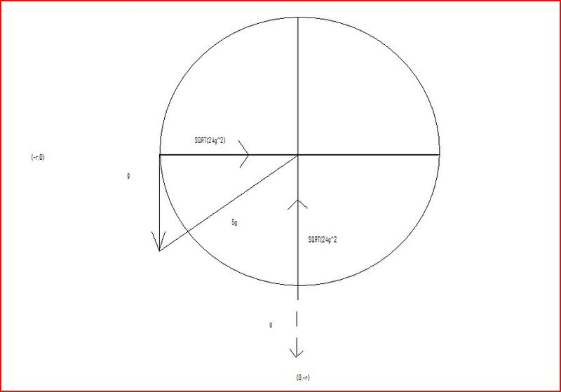

So you are suggesting that the magnitude of the horizontal acceleration before the "pull-up" to be 5g?
If I do take the horizontal acceleration to be 5g and the down ward acceleration, 1g, to be normal to the horizontal, then the magnitude is 50ms^-2
g = v^2/r and r works out to be 2200.

In post #26:
I can follow your reasoning in this post. But two questions. In moving vertically down(just before making the pull up), why is there a 4g acceleration towards the center? Wouldn't it make more sense to say that there exists a 4g acceleration to the center at the instantaneous moment when the "pull-up" was made?
I feel misread! Please read it again:
As soon as he pulls the wheel (or what do they call it -- A stick, I realized since then) towards him, a uniform circular motion sets in that requires 4g of acceleration towards the centre. His seat provides the force required for that acceleration. Also a vector, initially pointing to the right. So initially he feels an acceleration of 1 g down, 4g to the right. √17 magnitude total. Gradually going towards 1 g down and 4 g down as well just before point q. Magnitude now 5 g (same direction). He can stand that as per given in the OP. If he's smart he pulls up a little longer, haha. The moment he is going straight again, he experiences 1 g towards the center of the earth.
In post#29:
The 1 g acceleration down does not lead to a free fall. His seat pushes him up to oppose the gravitational force and it also pushes him up with 4g to keep him in a circular motion. These seat forces are in the same direction, hence the 5g.
