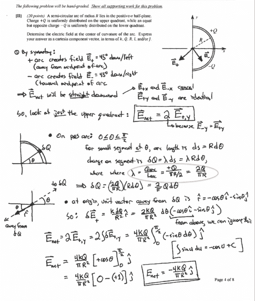

Help finding the Electric field at the center of charged arc
The discussion centers on understanding the calculation of the electric field at the center of a charged arc. The user is confused about the length of the arc being pi/R/2, questioning if it results from dividing the circumference of a circle by four due to evaluating a quarter circle. Confirmation is provided that the charge +Q is indeed spread over this quarter arc length. Additionally, the user seeks a simpler approach to the problem, expressing difficulty in following the teacher's solution. Clarification is offered, inviting further questions on specific confusing parts of the solution.
guyvsdcsniper
264
37
Determine electric field at center of curvature of arc.
E=KQ/r^2
I am having trouble understand where area circled in red.
I get that lamda is Q/L. The charge is +Q. Length is pi/R/2.
I am having trouble understanding why the length is pi/R/2? Is it because the circumference of a circle is 2*pi*R and since we have broken this problem down to just evaluating a quarter of the a circle, we divide 2*pi*R by 4 and get pi*R/2 which when we put that under Q we get 2Q/pi*R?
I wasnt sure until I typed out my question about and believe that may be the case, but just looking for some conformation.
Also, is there a simpler approach to this problem? My teacher wrote this out and I found it hard to follow.
Yes, I think you have correctly answered your own question. The charge +Q is spread out over a length of a quarter of a circle of radius R.
Your teacher's solution looks very good. If there is a specific place in the solution that you are confused about, we can help clarify.
