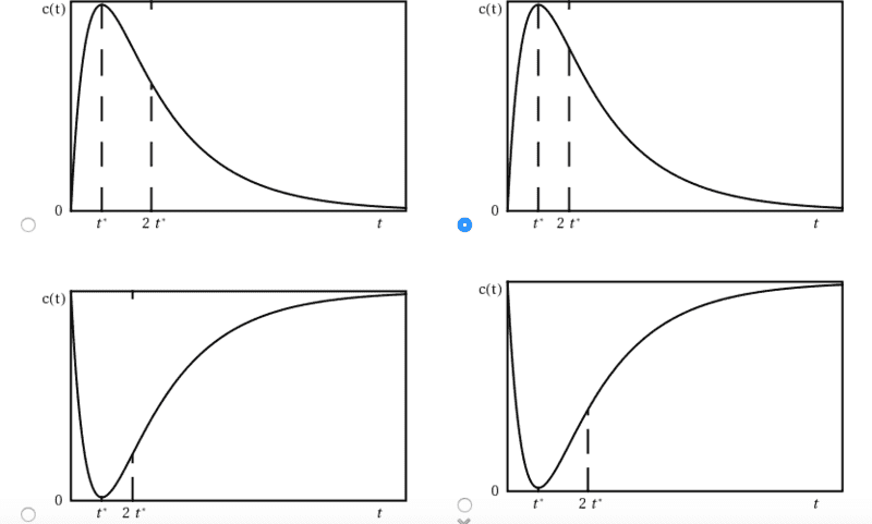

(c) what would the graph of c look like?
*attached picture shows options..
I did come to the conclusion that it has to be one of the top two graphs, but I don't know which one/why.

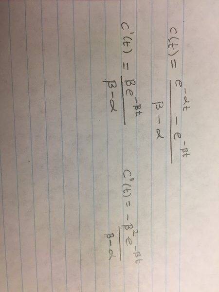

I know how to get the derivatives (see attached). But I don't know/understand what to do next. Also I have taken calculus.

Your derivatives are not correct. The ##e^{-\alpha t}## term is missing.
