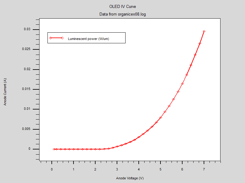

I am trying to simulate an OLED via Atlas SilvacoI want to know how to convert light power (watt/um) into luminance (cd/m2) or the syntax to do that in Atlas silvaco.THANKS

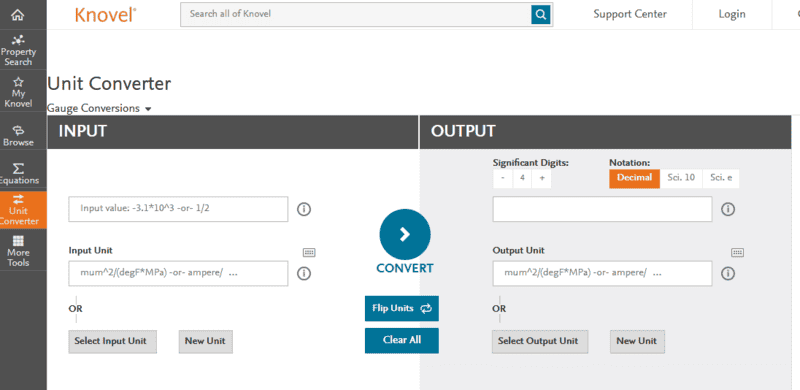

Once you get the units straightened out (watt/um does not appear to be a valid unit of luminance), try this site:
https://app.knovel.com/uc/
(unless that "um" term is micron, indicating wavelength. then you need to specify the bandwidth to get the total power. rather a can-of-worms i would say)
Cheers,
Tom
Thank you for your reply
this site did not work (https://app.knovel.com/uc/)
for the conversion there is an integration over the wavelength which must be carried out over the visible spectrum. but I can't insert this integration into the Atlas Silvaco code!!!
Site works fine for me using Google Chrome in Windows 10 Home.
Works for me as well with Windows 10 and Firefox.
@halaoui12 -- maybe some Internet problem with some blocking by your country?
