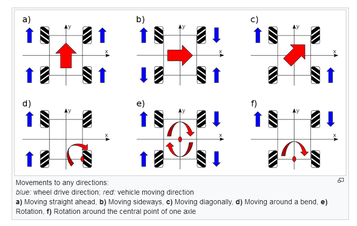

Wow, that's a weird wheel. What links have you been reading about how the wheel works in the different drive motions?
https://en.wikipedia.org/wiki/Mecanum_wheel
Also, is this project for schoolwork?
from 1:20

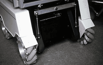

What kind of wheel system of this robot?
What do you think?
Really wonder how this been made
