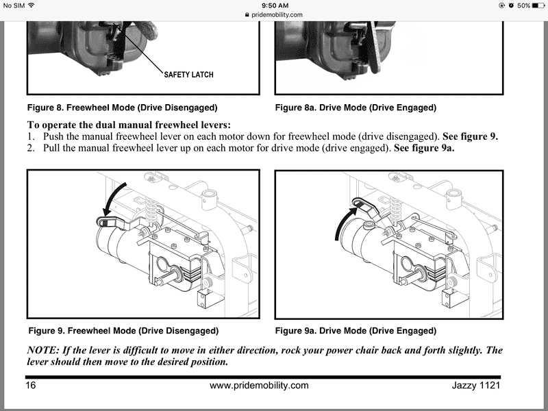

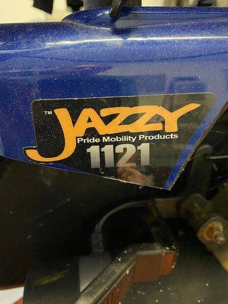

Can you post the make and model of wheelchair? Do you have diagrams of the power train in the owner's manual? Can you post pictures of the underside showing the motor and drive train?

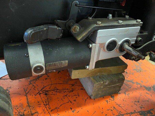

I thought of that and I opened the motor transmission to find it very neatly packed. I thought in order to put a smaller gear on the drive side, I would need a larger gear to match up to it on the other side but there is no room. The case is tight. I couldn't find much information on line and was hoping maybe someone is familiar with this. If there are any plug and play parts that might interchange with my motors or controller or perhaps another way with programming. It's beyond my knowledge on this matter but I'm innovative and trying to learn. thanks for you response
Welcome!
The stability of the chair and the power of the brakes should have decreased as well.
This is the manual, which contains a schematic of the motor-reducer assembly:
https://www.pridemobility.com/pdf/owners_manuals/intl_jazzy/uk/uk_jazzy_1121_om.pdf

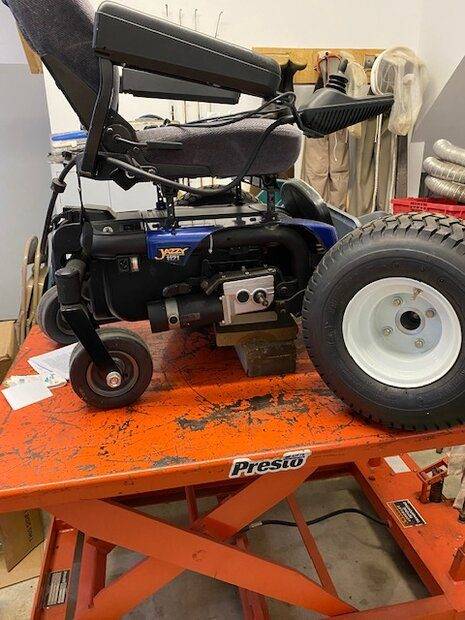

Could you post a picture of the modified chair?
Likes berkeman
The brakes seem to be fine. The stance I have widened with wheel adaptors I made on a lathe and I also mounted larger wheels and mounts on the rear tires. I have a small lathe and mill in my basement. Attached are a few photos. thanks for your help!
The tire's radius or distance between shaft and contact patch seems to have increased about 20%.

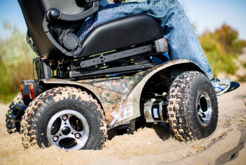

Have you looked into all terrain wheelchairs, sometimes referred to as rough terrain wheelchairs? There are a number of wheelchairs available that are specifically designed for unpaved terrain with steep slopes. Here is one that was randomly chosen from a search for all terrain wheelchairs:
Likes FactChecker, anorlunda, BillTre and 1 other person

The smaller gear would have a smaller diameter so it would no longer align to the larger gear. The axles are fixed in a very tight gearbox.
Hi, thanks for the reply. I have considered an all terrain wheelchair but they are too costly. I can build and fix many things and I thought it would give me an opportunity to build this for my father. I'm an OK welder and fabricator and have most tools at my disposal so it seemed like an interesting project. If possible I would like to move forward with this longer and maybe an idea will surface. The existing wheel was 11" in diameter and 3" thick and I have converted it to a 16" diameter wheel that is 8" wide. Thanks for your help and interest in my project.
Of course. I had it in head that they were linked by chain, not directly enmeshed.
Since you increased the wheel radius over 68% from the original, to get the same hill climbing ability you will need to increase the torque applied TO the wheels also by 68%.
That is a big ask for an existing power train! You can either change the gearing, thus slowing down the top speed (which was increased by the larger wheels), or increase the existing motor current by 68%. (Motor current is proportional to torque.)
If the motor current is increased then the motor will run much hotter and will probably self-destruct if run that way for an extended period.
That large a current increase will also require a heftier controller, the existing one most likely does not have that large a safety factor designed into it.
And then the batteries must be considered, the higher the load current the shorter the load-life of the batteries, the will have to replaced more often.
It looks like the only reasonable modification is change the gear ratio between the motor and wheels. Perhaps a chain drive could be added between the existing gearbox and the wheels, taking care to consider how to keep the chain clean.

You might consider mounting the wheels on separate axles, with the axles mounted to outboard supports. Then you could mount gears to the gearbox output shafts driving gears mounted to each wheel. An internal gear arrangement like this would keep the wheelchair at about the factory height, with no change in response to the speed controls:
Benefits to this approach are that the load on the gearbox stays the same, the wheelchair speeds stays the same, the wheelchair height stays the same, and the power required stays the same.
