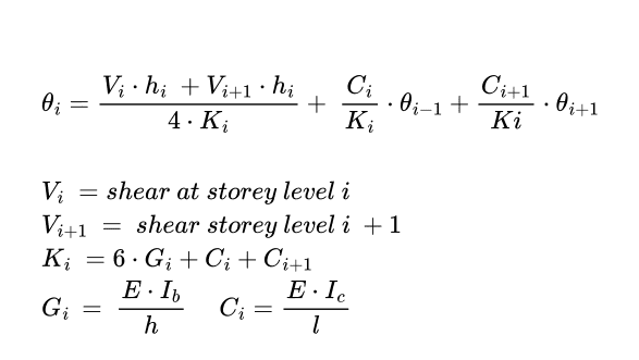

I am going through a book on multi-storey steel structures and I have come to a chapter that gives approximate methods to calculate rotations at the joints (The intersecting members) of a rigid frame. There is a recurrence equation that computes the rotations and this is given below:
The book mentions a few strategies to solve this equation. However, I am finding it quite difficult. The book mentions that you can use iterative methods and that you can start by approximating theta(i) as:
Is there anybody that can help with this, please?

I've never seen a recurrence formula like the one you showed. In all of the recurrence relations I've seen, to get the n-th value in the chain, you need one or more of the preceding values, plus a starting value or values. For example, a common recurrence relation for factorial numbers is given by ##n! = n \cdot (n - 1)!##, with ##1! = 1##.
Personally, I would use the iterative formula you wrote for ##\theta_i## to calculate as many terms in the sequence as you need.

Good point! This looks more like the situation with computational fluid dynamics, where the value at each point (i'th) depends on all surrounding values. That requires iteratively converging to a solution that is all compatible and consistent. I have no experience with those techniques, but I am sure that the solution depends on the initial values at all the boundary points. In this case, it would include assumptions about the initial values at both the bottom and top story.
