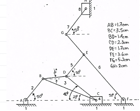

Find the aceleration of each link in the mechanism
W = V´2/r
Hi guys!
I have problems with this mechanism...finding the aceleration with graphic method.

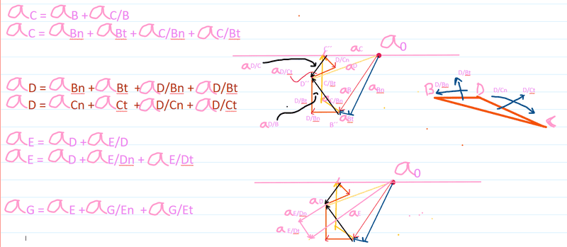

I already have drawn the speed diagram and the values of all of them.
But, i dont know if my aceleration diagram it is well drawn. I'm stuck especially when trying to plot and calculate the acceleration of "G"
What is the direction of rotation?
counterclockwise (2 link AB)
Thank you.
Could you show us your work on velocities?
